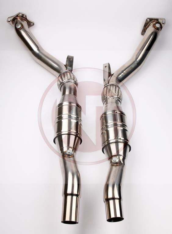

    Wagner 3" SS downpipes with sports cats - I had to cut and weld the right downpipe so it would clear the gearbox bracket, but besides that it fitted perfect.

      You've done 4 mods I was planning to do, wagner kit and jetex exhaust, how does it sound and how is the wagner kit?

                        Also the wagner downpipes and exhaust manifolds are a piece of beauty
                        The wagner downpipes will fit the A6 C5 but I did have to do some cutting and welding since it was fouling the gearbox.,
