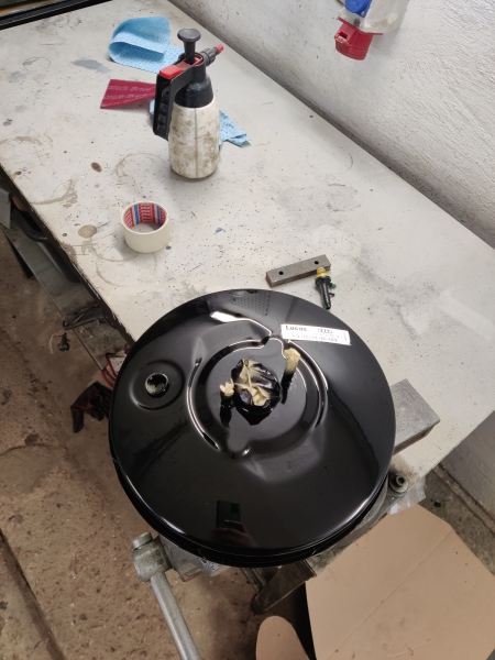

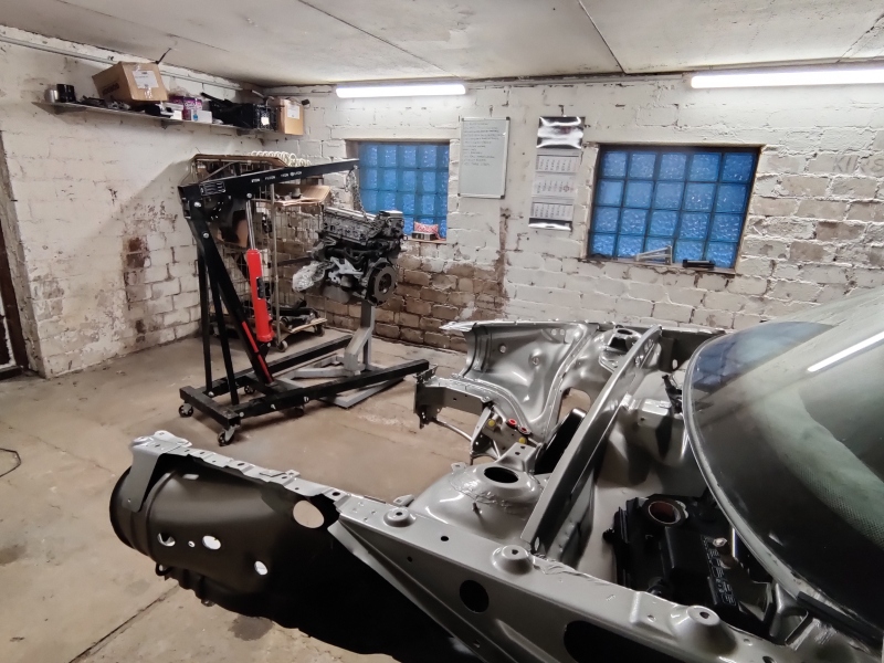

      Installed drive by wire to the car. Start to look like a car soon. Clutch is back with new pads.
      Engine in stand allready.
      Made brake booster looke like new.
