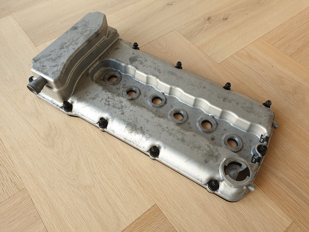

              Parts for the engine swap I already have.
              EFR-7163-AL 0.85A/R with integrated wastegate en BOV from Z-turbo and SX-E compressor housing.
              Phaeton belly pan.
              Phaeton adapter plate between VR6 and 01E gearbox.
              Phaeton valve cover.
