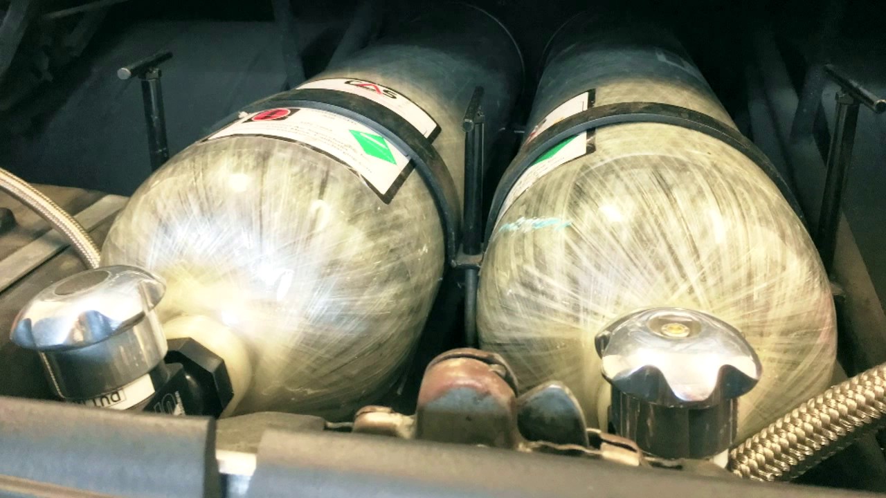

                        If you're only doing really short runs
                              https://www.youtube.com/watch?v=qObzWnWlCfM
                              Interesting info, thanks for posting Steve. Cheers Simon
