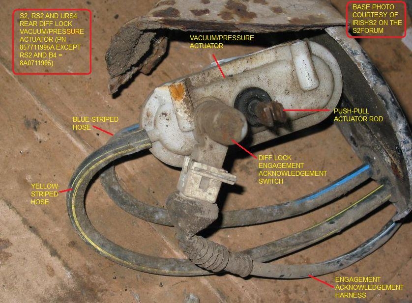

    I notice I am able to move the rod from the actuator under the car in and out without any significant resistance, is this normal ?

    Could be as simple as a leaking vacuum hose.
    Lots of info at Diff Lock 101:

      Thanks, that's just the info I need.
      Looks like blue hose is probably the disengage vacuum supply, I will try it out.

        Yep, either the blue-striped or the yellow-stripped one. (I've never bothered to figure it out since mine works fine). Let us know (please) and I will add the info to Diff Lock 101.

              As part of my sub-frame refurb I have the actuation mechanism out and I can confirm that on my car:
              Pipe with yellow stripe = engage vacuum
              Pipe with blue stripe = disengage vacuum
