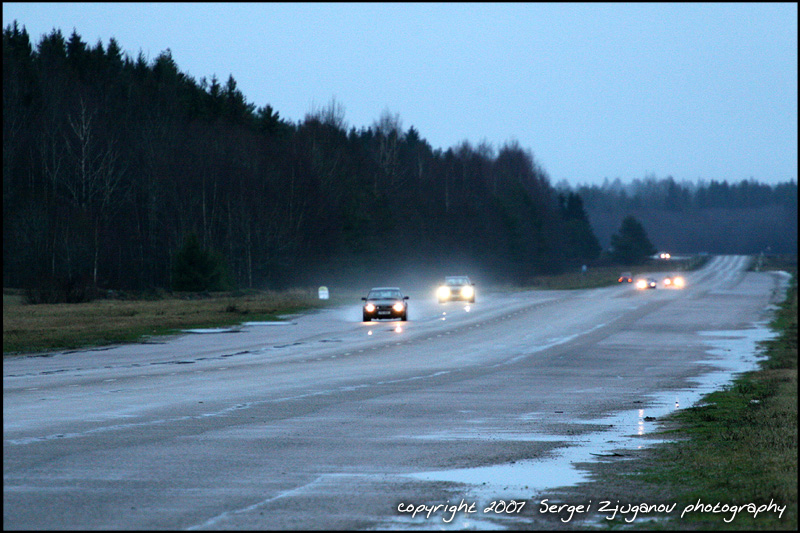

    Here is the race: stock RS4 and my S4, I have advantage ground ca 30m

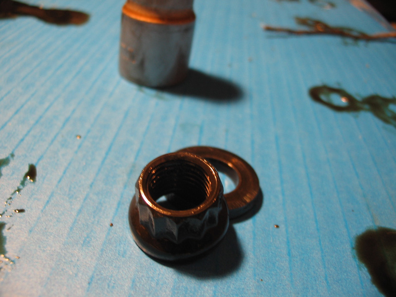

                I already have ARP bolts and studs:
                The Sport Quattro exhaust manifold are good up to 550HP. And I have that collector:

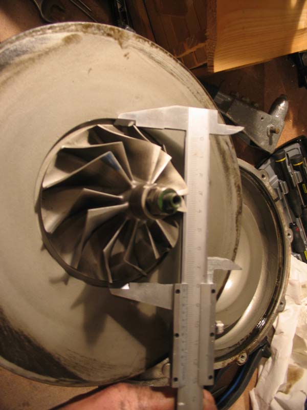

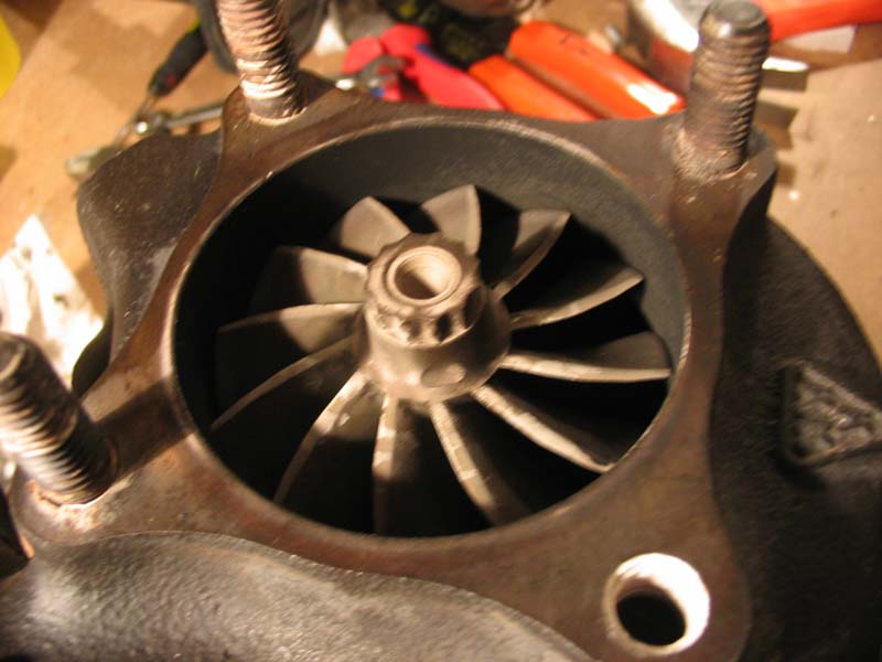

                      KKK sizes:
                      Compressor wheel max diameter is: 82mm
                      Compressor inlet diameter is: 61mm
                      Turbine inlet diameter is marked #7
                      Turbine outlet diamter is 69mm
                      Question: what the max productive power for that KKK turbo? I think 500HP.
                      Is the turbine inlet #10 or #11 better than #7?
                      Suggestion are welcome for more power
