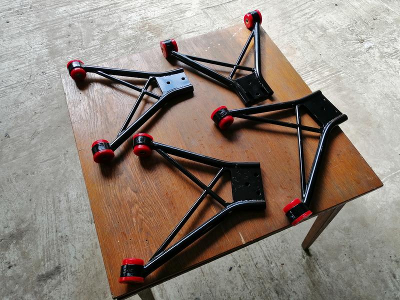

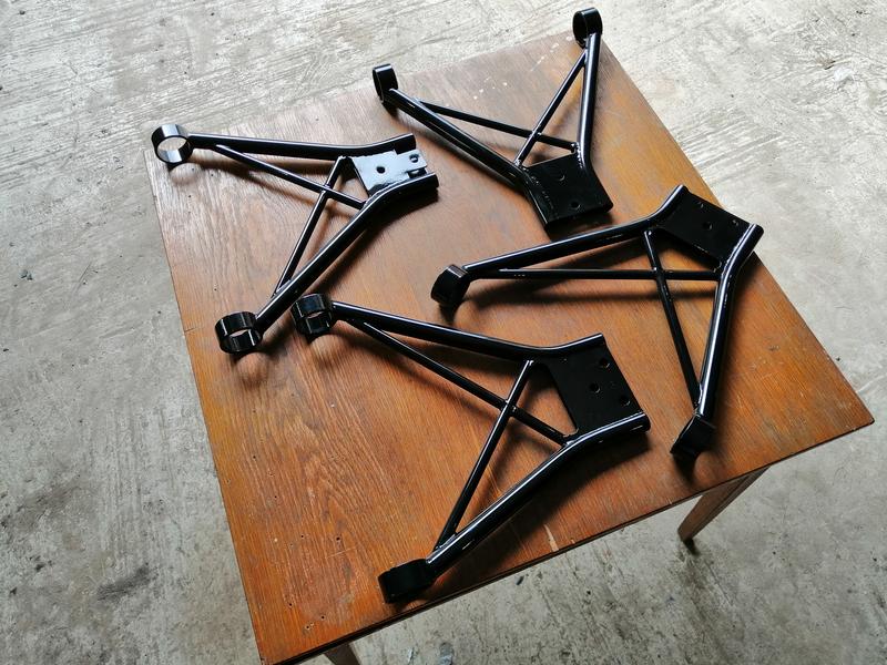

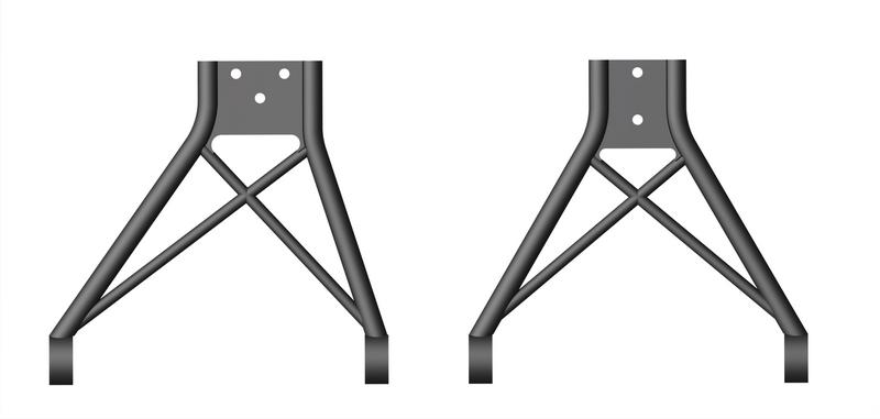

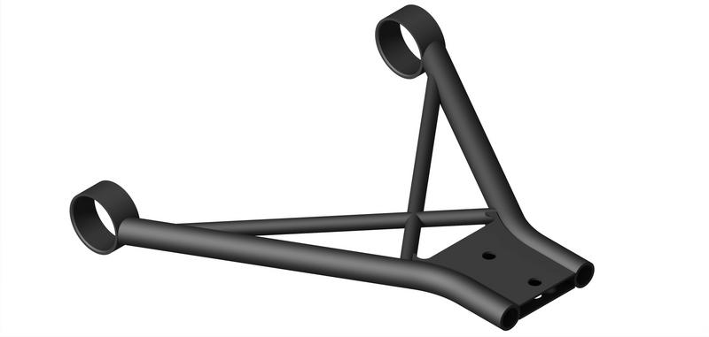

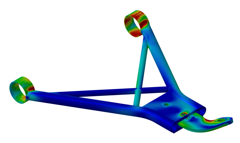

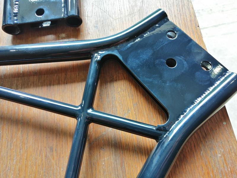

    Type89 coupe tubular wishbones
    There was an idea to make stronger wishbones than original for personal usage but then i thought i put it up here all so.
    * Made out of S355 tubing
    * Tig welded
    * Blasted with glass after welding
    * Powder coated
    * Front and rare bushings are used 45mm ones
    * Made on order, for now.
    I know the bends on wishbones might seem going pretty close to arbs but i can assure that with rare you dont find any problems and up front i have rs2 arb and still no rubbing or colliding with it even with hard driving.

    They are really nice. The price is good especially with the bushes..

        Bushes are not include, sorry. Just a picture taken in real life for a good view just before i installed my set.

          They look really nicely made and substantially stronger than the pressed steel items. Well done!
