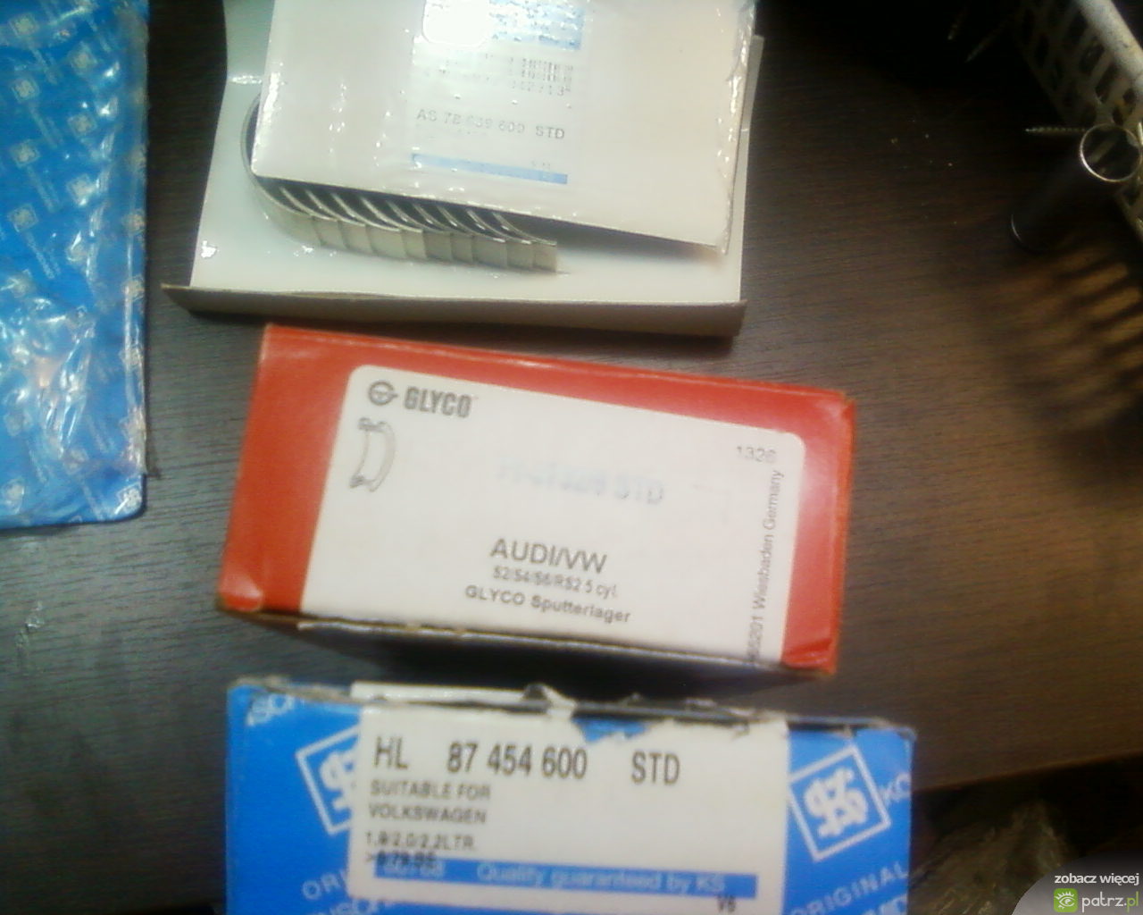

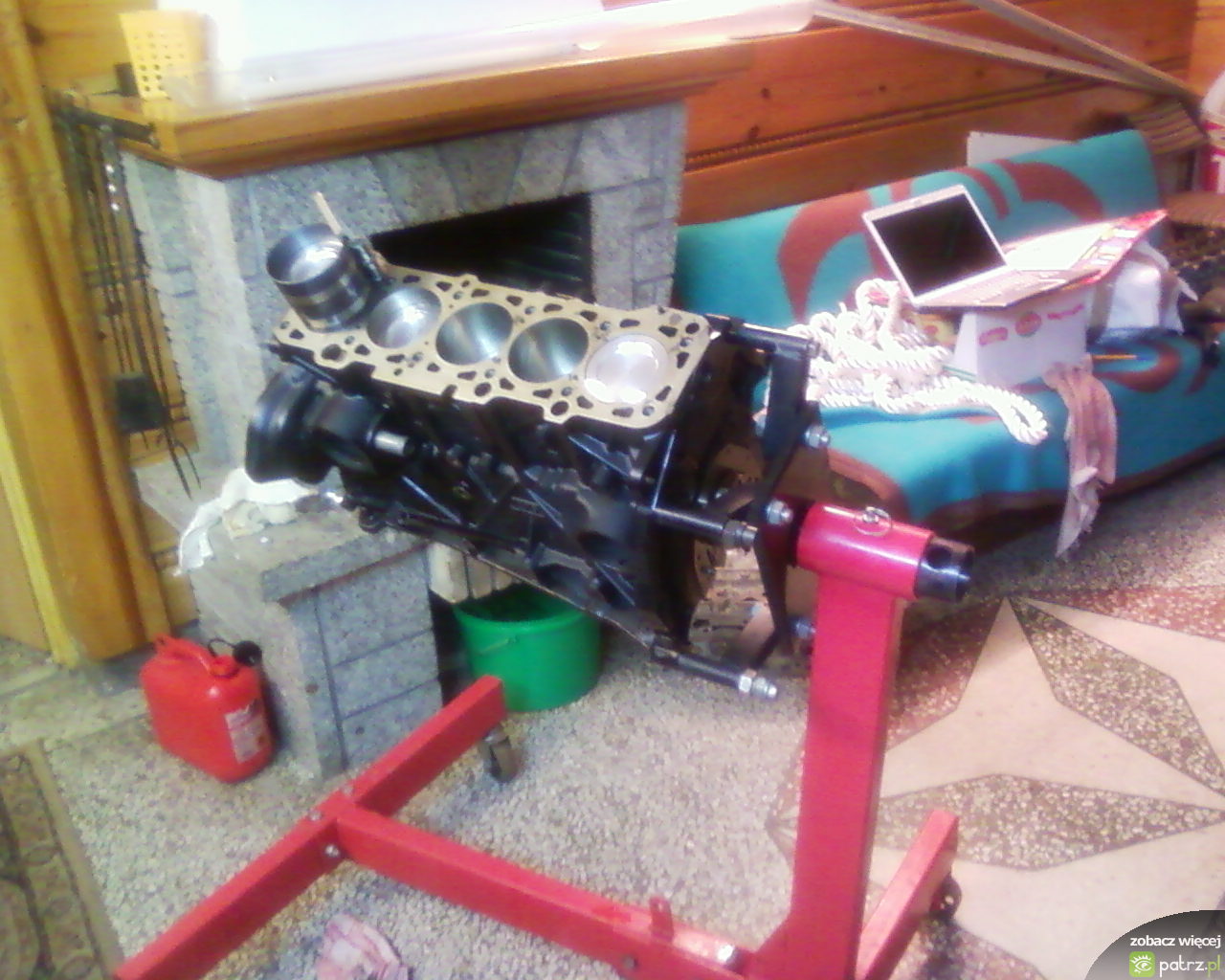

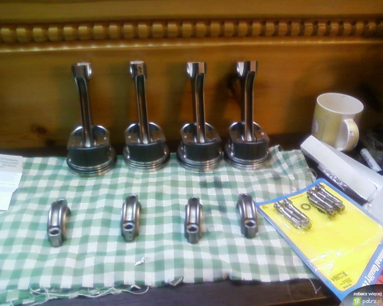

      The box in the middle of the top picture shows 'combined thrust washers'...DO NOT USE...THEY WILL FAIL.
      You need to use seperate 'thrust washers' at the middle bearing position.
      The problem is the 'combined' type do not have a big enough surface area to 'absorb' to pressure.
      I have used these:-
      Main bearings, Glyco. H981/6 STD
      Main thrust bearings, Glyco. A124/4 STD
      Carlos.

        Staszek told me that on picture - middle box photos is not original box from bearing , he use seperate 'thrust washers' like you write .

          Good to hear...

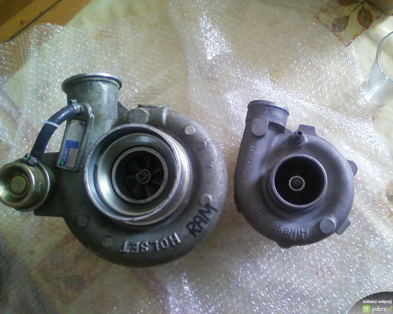

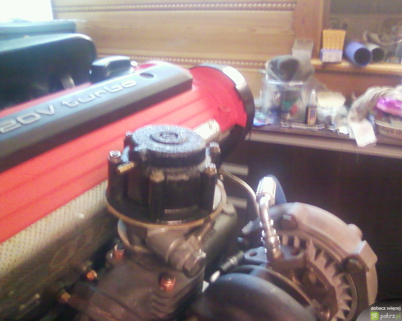

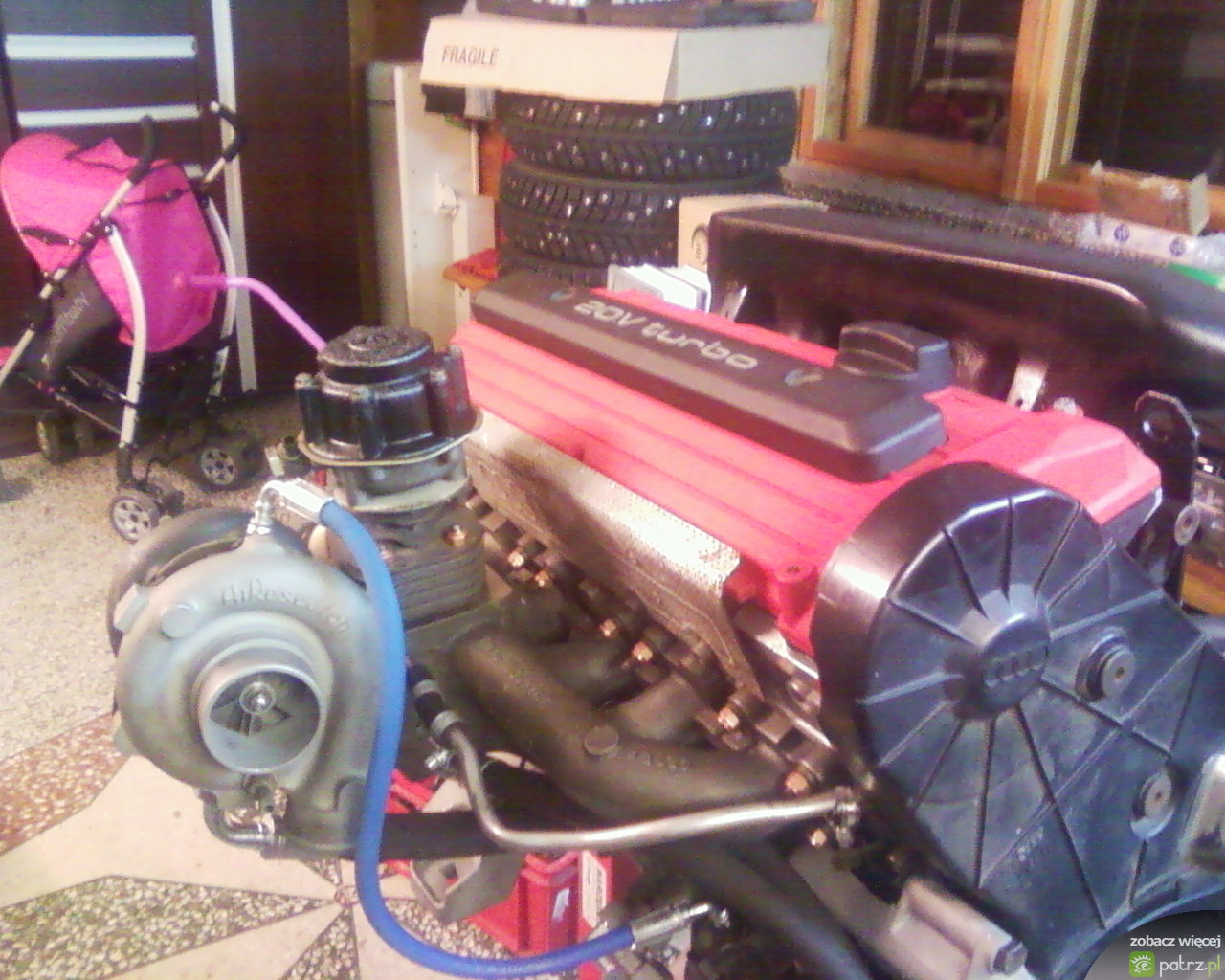

                  new turbo , holset hx35 , 7 blade ( dodge ram 5.9 diesel )

                    vems
                    holset hx35 7 blade
                    630ccm injectors
