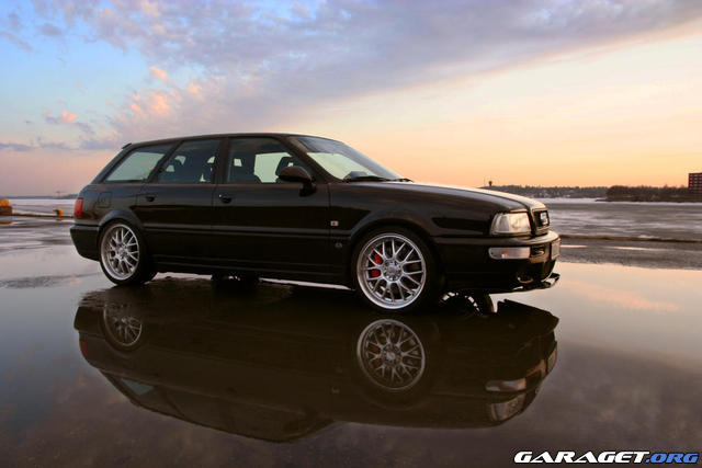

    I had a pretty cool S2 Avant with 500-600 hp depending on mood and fuel in the tank, once it was on a good mood and this happend
    Among other stuff, it still runs and best time is 11.44 @ 200 km/h on the quarter. It is a full year car, it runs even in the wintertime, pretty happy with that build, and the new owner is happy with the car too.

    And after I'm finished with this car, I'm rebuilding maniac's (on this forum) aby engine, his car has some nice stuff on it, but the engine was unfortunately built by neanderthals so I'm hopefully sorting this out for him. Mikkal is a nice guy with a lot of patience and the right attitude towards tuned cars, I hope he will enjoy his nice Avant after I'm done with the engine, this is a picture of his lovely car.
    It has SPM rods, KX500 turbo, custom EM and 7a cams (not sure about the cams) , and a spec clutch.
