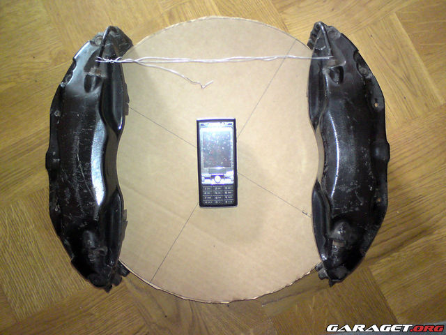

    Hi!
    I bought some Audi S8 Brembo calipers for my S2, now i cant find any slotted Audi S8 345x30mm discs.
    They are hard to find in Sweden, and the ones i found was great expensive.
    Do anyone know where i can find them like in the U.K or some other country that is cheaper than in Sweden?
