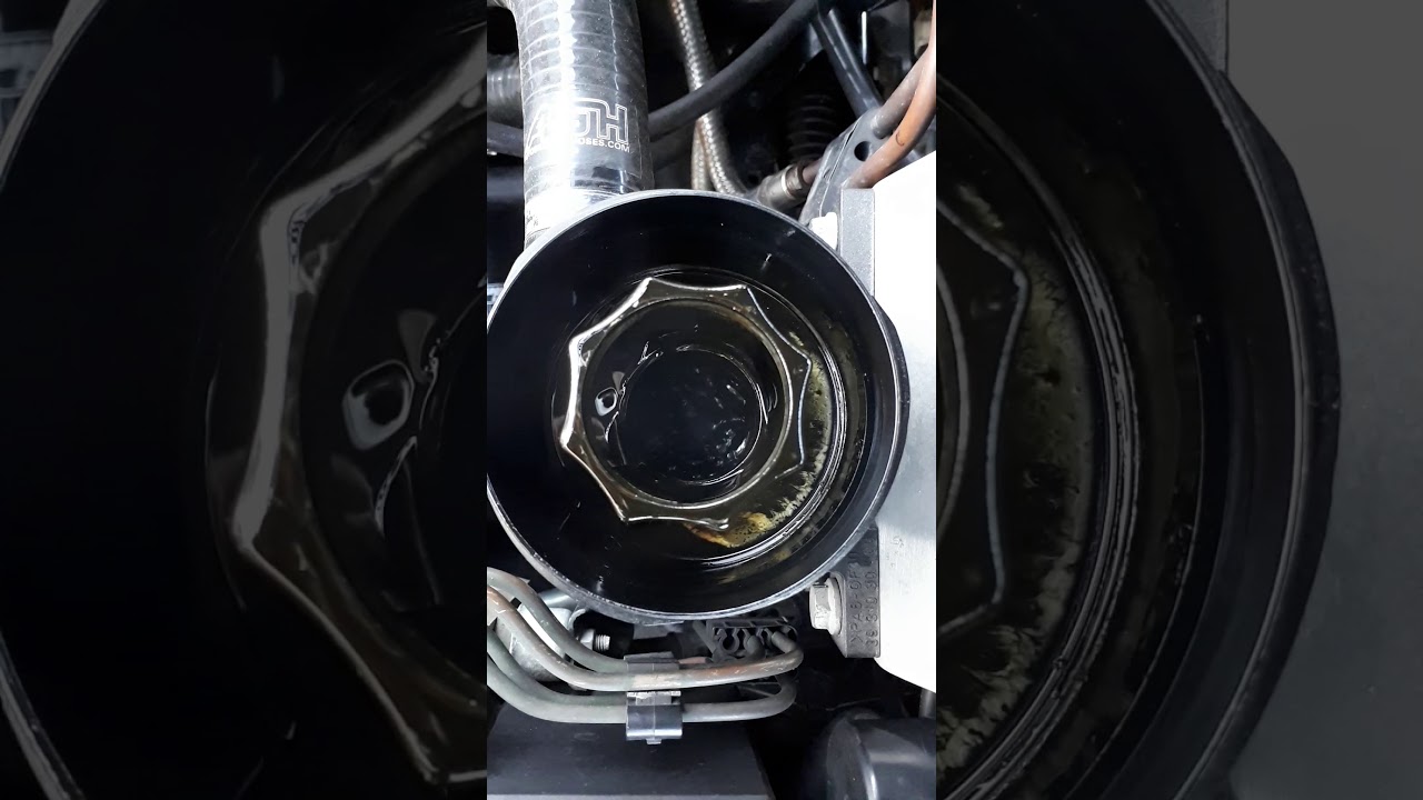

    Car was going great today in the cold weather, until it started throwing up a smoke screen any time i stopped at traffic lights
    Where is the best place to get a quickie rebuild done, or has anybody tackled it DIY with one of the eBay kits?

      Well this is embarrassing, i checked the oil separator and its brimmed to the top with engine oil. No wonder it was smoking at idle, doh

        It's great that that's all it was. A lot less grief.
