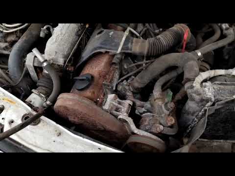

                  Some time has past, at this point I could say this need a build thread as facebook isn't doing us the justice.
                  Started disassembling the engine to make it lighter to finally move it to garage that car is in and do all the little things to do swap in ''one constant swoop''
                  I have this odd commitment to make this engine work with old exhaust seeing that b2CQ community has had some luck with welding the manifold so I'm still fighting for every last bolt. So far, 2 out of 5 exaust pins have snapped, will change tactics and pray lower side does better.
