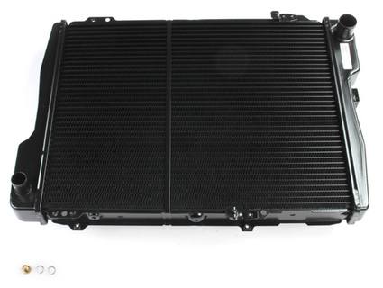

                    the Nissens (60442) radiator i got recently is alloy
                    while mahle, Behr has plastic end
                      https://storage.googleapis.com/part-...mark/60442.jpg
                      Where did you get your Nissens 60442 from? Was it labelled 60442, new in a box? Mine was from Euro Car Parts a few months ago and it's got plastic ends of a different shape and silver fins. I wonder if you have a better, older design or perhaps Nissens listened to my complaints and changed the design

                        USA. most of the stores has the nissen with plastic ends. But few listed the (most likely) old style, with metal end.
                        I emailed them, just to confirm its the one on the picture
                        Find Nissens, 60442 Radiator; Main Radiator 893121251G at discount prices in our extensive Audi auto parts catalog. AutohausAZ offers a large selection of Nissens parts online. For models with manual transmissions. 1 per car. Fits Audi 90 Quattro, Coupe Quattro, 80 Quattro, 80, 90. 376711281 60442 W0133-1600798
                        https://eeuroparts.com/product/nissens/60442

                          The older ones with the metal end tanks were the ones that had all the leaking problems in the past.

                            That's right, the one in the pic Varia linked to is the old type with brass/copper alloy end tanks, these are okay (better than the brittle plastic tank version) but still prone to cracking and leaking especially around the bottom mount, which can be repaired fairly easily.
                            The best quality OE radiators are the Behr/Mahle version, sure they have plastic end tanks but these are way robust than the one's on any of the other options and the core's are vastly superior. You can also swap end tanks on them should you damage one which is impossible with the Nissens plastic version.
