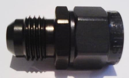

    Can anyone please tell me what thread type and size it is IN on the stock FPR on my 3B engine? I am changing to AN-type fuel lines, and I need an adapter to AN from the stock thread type, so that why I need to know The fuelrail is also going out.
    Can anyone help me, please?

          I checked a little bit at 034MS and I wonder if I can use this ?:
          I need som type of adapter so I can fit AN.

            The 034 wont work as I have tried, this does:
            Speedflow - Bosch fuel regulator fitting Gives male -6 AN to allow high performance hose connection Has a convex seat on the female metric port. See all our products here

              If I were doing it again. I would cut the metric off and weld on some steel male An fittings on. Then you also have half the amount of joints to worry about

                I've used these, but it ends up quite bulky.
                Terry's idea would be neater and have less joints, as he says.
