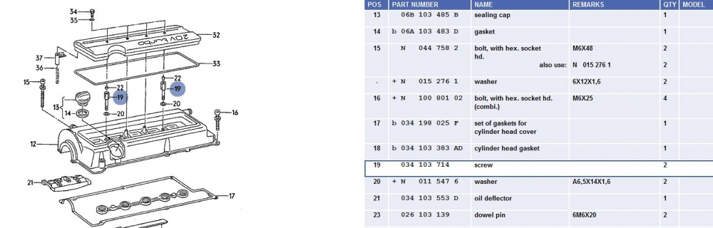

Ok, I need to change the cam cover gasket and I have removed the 6 allen head nuts.
I can't seem to get break the seal and get the top off, am I missing something obvious???
Ta
Ok, I need to change the cam cover gasket and I have removed the 6 allen head nuts. I can't seem to get break the seal and get the top off, am I missing something obvious??? Ta
For future reference, in addition to removing the Item 15 and 16 bolts (pay attention that they are two different lengths), you also need to remove the Item 19 studs.
