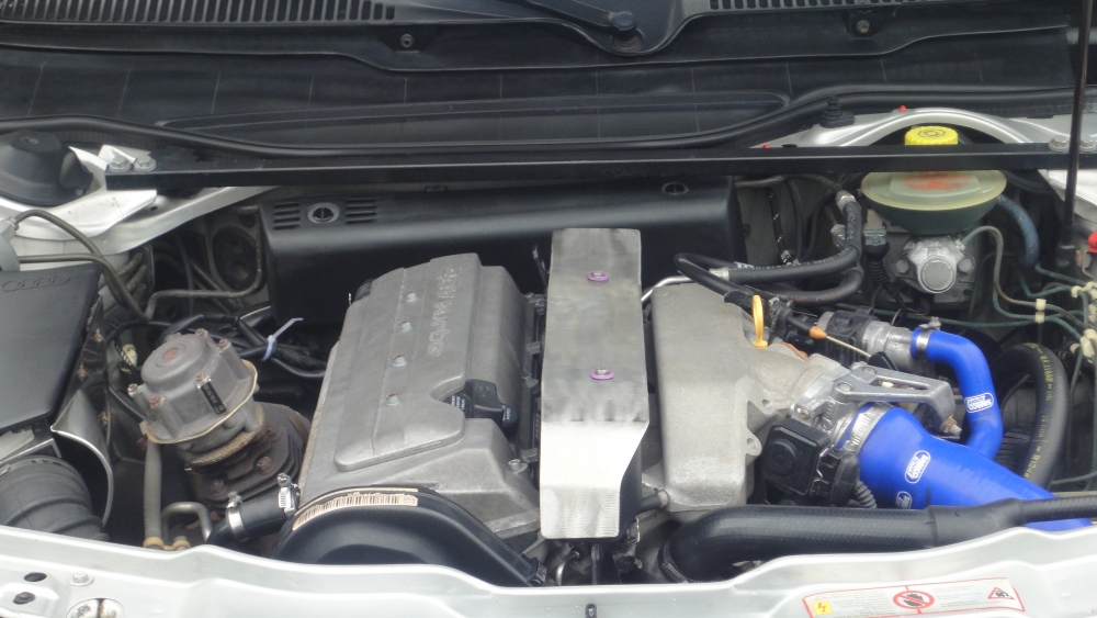

UrS4 and early UrS6:
Thanks for the S-Fest 2010 Photo whoever took it
ABY cover:
Late (?) UrS6 cover
Thanks to whoever took this S-Fest 2010 photoRS2'd 93 UrS4 5 spd sedan
