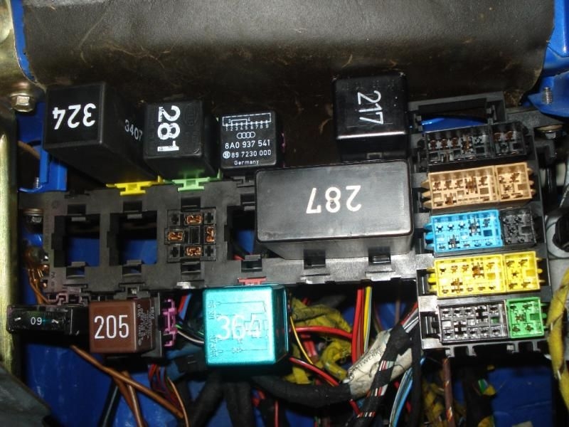

              After-run Auxiliary Coolant Pump and Fan Switch and 324 Control Module Info
              Originally posted by EvenM
              Hello I also have a problem with a cooling fan living its own life. Did you solve your problem ? Any other tips?
              Could be related to the after-run pump switch and control module:
              After-run Auxiliary Coolant Pump and Fan Switch and 324 Control Module Info:
