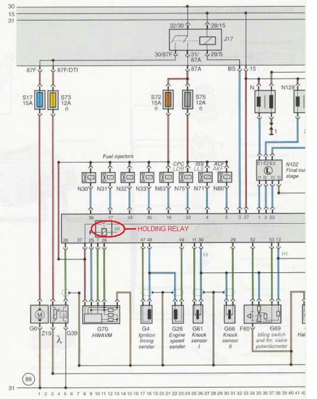

            Sounds like the Holding Relay in the ECU has failed at least partially. One of its purposes is to supply power to the hot wire after the engine is off in order to burn off crud. But this is only supposed to go on for around 5 seconds. Sounds like the relay got stuck closed, at least on that function. Swapping ECUs swapped out the failed Holding Relay at the same time.

                            Thanks. I am pretty sure the burn-off signal wire is still in No. 4 of your MAF harness connector, i.e. the blue one with the violet stripe.
                              Accessing Paul N's ADU wiring diagrams, the answer is "YES", the blue/violet wire does come from Pin T55/25 in the ECU, i.e., the holding relay power signal to the burn-off function for the hotwire.
                              The wiring listing for the ADU MAF connector is:
                              Position 1 = Brown/yellow to (138) ground (probably the intake manifold?)
                              Position 2 = Black/green from Pin T55/26 in the ADU ECU (looks like this one might be a white/green wire for an ABY)
                              Position 3 = Black/white from Pin T55/7 in the ADU ECU
                              Position 4 = Blue/violet from Pin T55/25 (holding relay) in the ADU ECU
                              Position 5 = Blue/black 12V power wire connected to the injector wire power circuit which is connected to Pin T55/37 in the ADU ECU (actually from the Holding Relay in the ECU)
                              There should not be power in Position 5 until the ignition is turned on. As with the hot maf (from power going through Position 4 long after the normal 5 seconds of engine off), this is a bad sign that the Holding relay is fubar'd.
                              RS2 G70 MAF Schematic:
