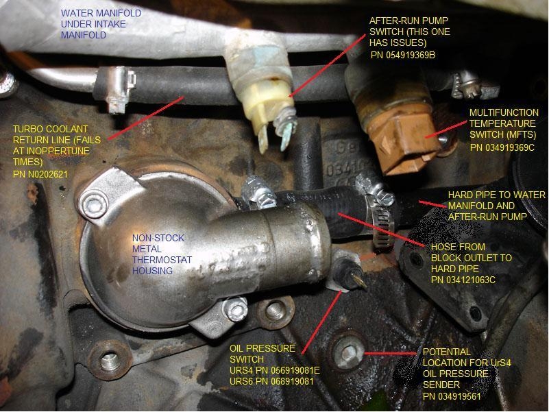

Anybody know where I might get some of this hose online?
It's on back order from my local dealer with no sign of it coming in,car is parked up the last 2 weeks waiting on it

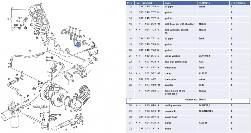

For those who might be able to help but don't immediately remember what N0202621 means, it is the turbo coolant return hose under the water manifold on the intake side of the engine. The hose is somewhat special because it has to run at more than the general coolant temp (87-90 C) because it is returning the coolant that has just gone through the very hot turbo. While OE would still be my recommendation, some people have tried a multilayer silicone hose with some success (not failed yet). Other folks have suggested that high temp hydraulic fluid hose might work. No comment.
