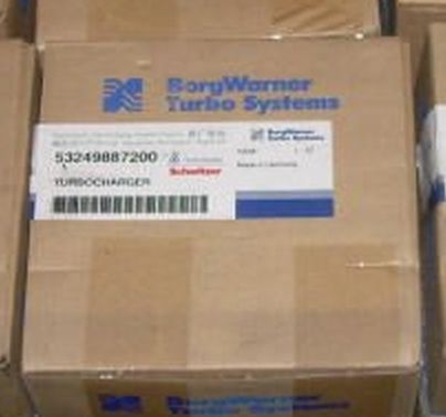

                              Originally posted by piotr
                              thank you very much for your advice guys.i will keep this turbo as it is . as promissed - part number picture below.
                              Thanks. So it looks like yours is one of the Borg-Warner 5324-988-7200 KKK K24-7200 clones that they built to supply demand without going through the Audi part system. Not original RS2 OE but supposedly exactly the same, maybe with the odd improvement (or not).
                              Yours:
                              The pallet of these 5324-988-7200 turbos at Force 5 in the US at one point:
