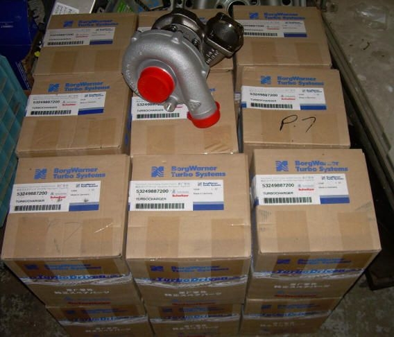

                    At the end of the day, I got this
                    RS2 >> Ferrari: Performance/look ratio
                      #25
                      Try again. You sent us thumbnails not full-sized photos.

                        #26
                        Sorry I didn't realize it's so small

                          #27
                          KKK made the K24-7000 and K24-7200 turbos (7000 = 3B, AAN and ABY); 7200 = ADU RS2).
                          At some point before 2004, Borg-Warner bought the turbo division of KKK.
                          Around 2004 Borg-Warner started making "clone" RS2 turbos, using RS2 specs and parts but outside of the Audi and Porsche parts system. Yours is one of those later RS2 turbo clones. The key part is the last 4 numbers in the part number, i.e. 7200.

                              #29
                              Yes I think so too. I'll have my original turbo out soon, will see if there is any difference.
