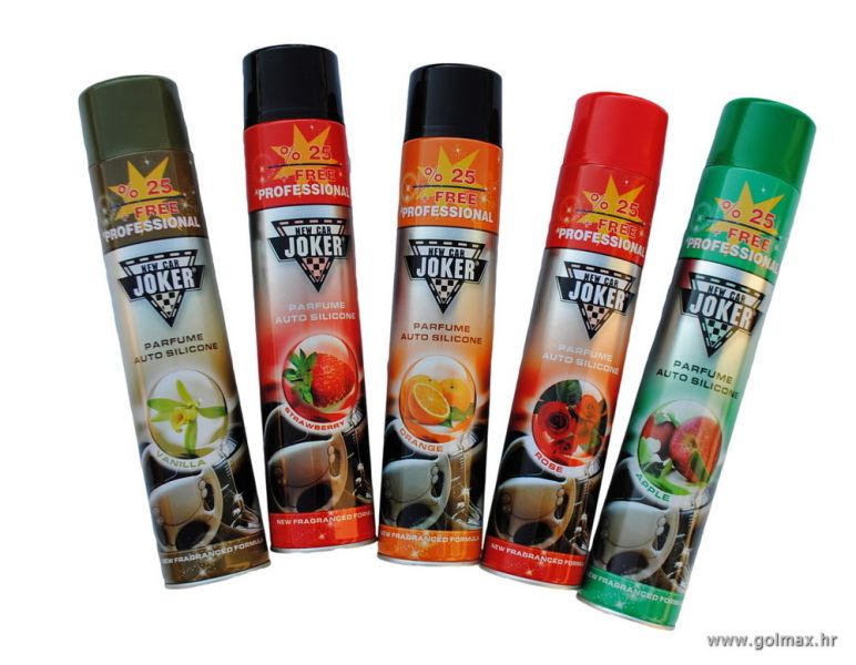

    I have strange problem with my car,it all started before a grand car show when a friend sprayed my engine bay with product for dash "glow",something like this
    After that car start going in limp mode after 4000rpm in 4th and 5th(didnt test in 6th)

    Any clue what could be wrong?I sopose that the sprey made this since evrything was fine before that
    P.S. I wasnt near the car when he did that,becose i wouldnt let him do that...

      It might be pure coincidence or it might be real (somehow the spare resulted in a bad connection (somehow )). In any event here is a hyperlink to some G71 Manifold Absolutue Pressure sender info to read:
