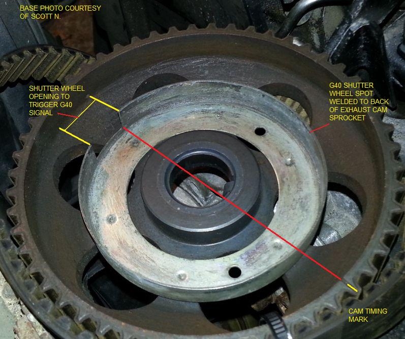

Fit? Yes. Allow your ABY engine to run? No.
The problem is the 7A exhaust cam sprocket lacks the shutter wheel needed for the G40 cam position sensor to work, at least for AANs after Feb. 1992.
Back of a 7A cam sprocket:
Back of an AAN or ABY shutter wheel (ADU similar but different)
94 UrS4 V8 6 spd manual avantComment
Again Dave you are there to enlighten us allFit? Yes. Allow your ABY engine to run? No.
