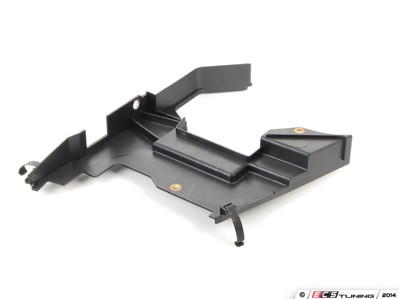

    The front cover plate PN 054109123B Item 3 seems to be available over here for about US$86. Aaron (Aronmatic makes and sells beautiful Carbon fibre versions)
    http://audi.7zap.com/en/usa/audi+a6+.../109-109070/#3
    The rear cover Item 1 in the link above with the clips PN 054109143B also seems to be available, for about the same US$86 price.
    https://www.ecstuning.com/Search/Sit...143B/ES277022/
    The bar code sticker like the one below, is unique to that engine and as such was likely printed at the engine factory as a one off. You'd have to contact Audi Tradition to see if they can be reprinted.
