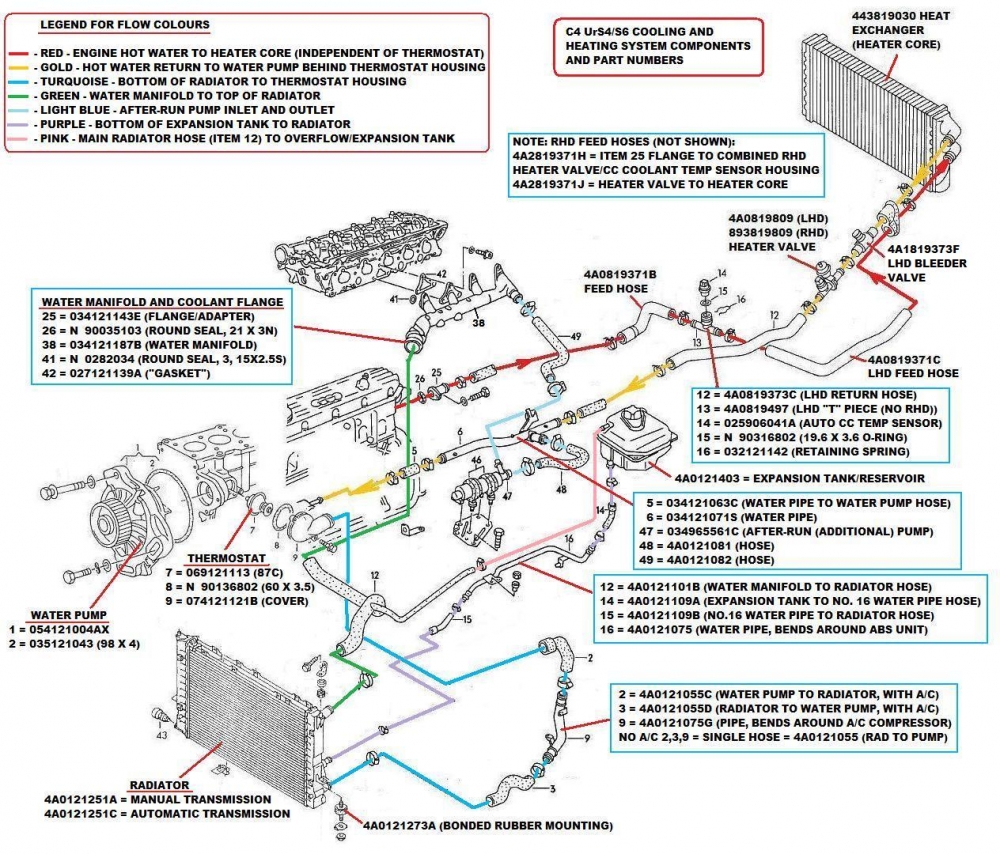

    20VT Potenial coolant leakage locations
    1. Head gasket - obvious. Sometimes possible to observe bubbling in overflow tank due to compression leakage.
    2. Any of the coolant/HVAC hoses http://forums.quattroworld.com/s4s6/msgs/301760.phtml
    3. The water manifold gaskets http://forums.quattroworld.com/s4s6/msgs/301767.phtml
    4. The hoses under the intake manifold
    5. The turbo coolant feed line http://forums.quattroworld.com/s4s6/msgs/72682.phtml
    6. The after-run pump http://forums.quattroworld.com/s4s6/msgs/21503.phtml
    7. The casting plug at the back of the head http://forums.quattroworld.com/s4s6/msgs/319651.phtml
    Photo courtesy of Newsh on the S2Forum
    8. See the link in item 2 above for anything that I've missed

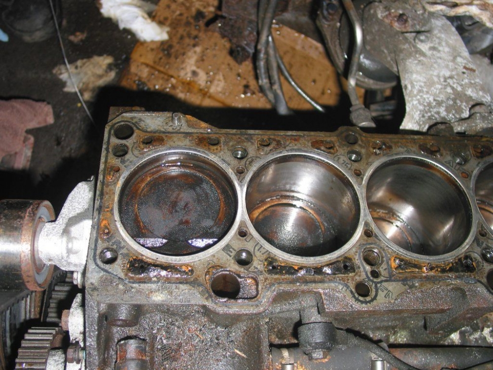

                Head gasket changes from composite to all metal
                Originally posted by macspring
                Did the later AAN engines not have metal gaskets from the factory ? Car is a 1996 model year. Thanks.

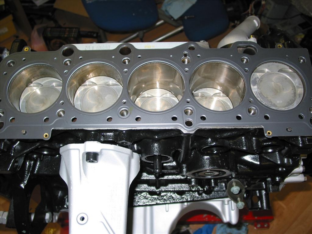

                The original UrS AAN engines came with a combination "paper" (impregnated fibre) and metal head gasket, i.e. a composite head gasket. The PN for this composite headgasket number was 034103383AB. When I asked my good friend Kate about that PN, she says:
                "Dropped on 30/09/1994, please use as replacement: 034103383AD". 383AD is the all metal headgasket and now is the only good PN in the system, for the 3B, AAN, ABY and ADU.
                Composite head gasket:
                All metal head gasket:
