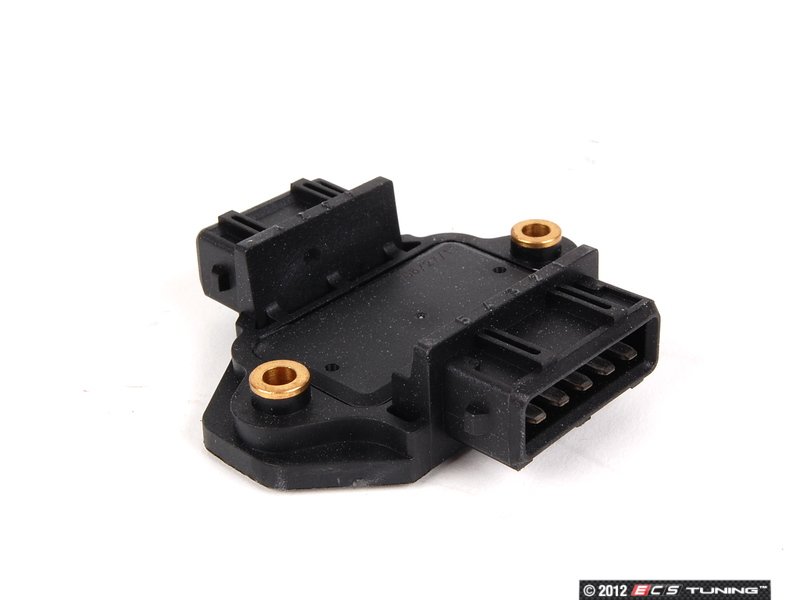

            The S6plus is indeed coilpack on plug but unlike the later V8s, it has external POSs, not integral internal POSs. In fact the POSs are the same as the early A4 1.8T POSs, i.e. the input side has 5 pins and the out put side has 4 pins. The AHK just has two of these. http://audi.7zap.com/en/rdw/audi+s6+.../905-905035/#1
            PN is 4D0905351 Huco and Bosch both make them. https://www.ecstuning.com/Audi-B5_A4...ews/ES2515501/
