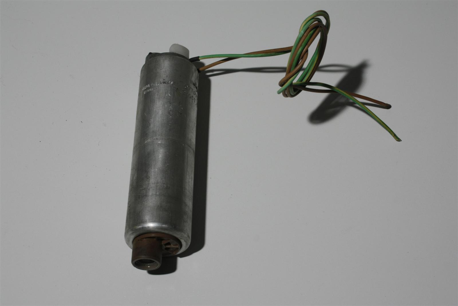

            RS2 Fuel Pump = 895906089E (longer than the C4 AAN 8A0906091G fuel pump) but also used on several other less powerful Audis.
            Some options:
            http://www.ebay.com/itm/Audi-RS2-P1-...-/131093705587
            http://shop.autewo.de/Antrieb---Moto...40217300_u341/
