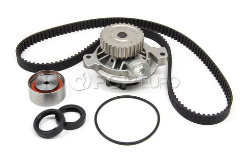

          The point of the story is when you are doing timing belt on an AAN (or ABY or ADU) you want to use an OE supplier (Graf or Hepu) water pump, not some generic cheap Chinese cr@p. He has 190,000 miles on the engine so far and it survived this non-fatal failure to live on.
          One AAN kit with decent parts listed: https://www.fcpeuro.com/products/aud...-s4-s6-s4s6kit

                    Originally posted by slacky
                    Hi Dave , is this the kit you've used in the past ?
                    No. But it contains the same parts that I bought when I did my timing belt in 2011.
                    IF the kit indeed contains those parts, its probably a good deal. There must be somebody in the UK that would (should?) offer the same parts.
