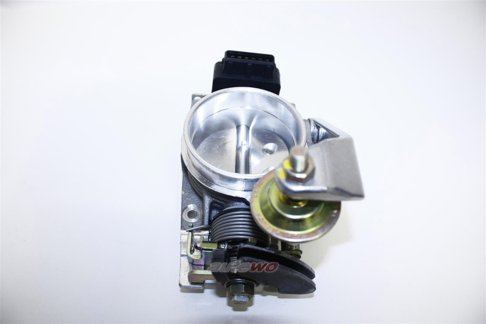

    Anyone got a link for a good wide clip to hold my throttle body samco on? Keep on blowing it off and to be fair my clip is a skinny one.

    An oem hose or a URS4 throttle body (which is wider) is the only cure I ever found for this.

      I've had this issue recently and just resolved it. There isn't enough width on stock S2 throttle body to go for a wider clip so you need to use one about 6-7mm if I recall. That is just right and it is hard to get it adjusted just so in my experience.
      I did mine with the throttle body off the car, granted it was very difficult to get the throttle body back on the car with the hose already in place but it is airtight now
      1996 S2 ABY Silver
        IIRC there is an issue with the Samco hose not being quite long enough either?
        As Colesy said the AAN throttle body has a longer spigot on it so worth trying to find one.
            Yup. See below:
            3B (and RR) throttle body: 034133063DP
            ABY and ADU throttle body: 034133063EE
            AAN throttle body: 034133063EF
