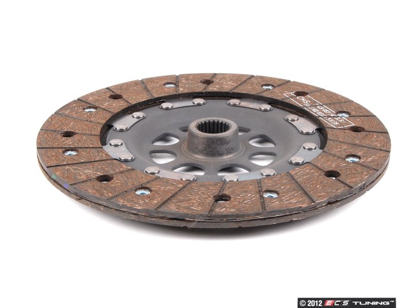

    Quick question. Does ADU friction plate fit AAN DM flywheel with AAN pressure plate? I want to combine a DMF with a spring-damped friction plate from RS2. The friction plate in question is a Sachs 88 1861 999 820 which I want to use with pressure plate - Sachs 88 3082 999 754.

    It will fit (same 240 mm diameter, same splines, but why do you want to further soften the clutch??)
    AAN - 034141033X, no springs (springs are in the DMFW)
    ADU -034141033A, springs, SMFW, dog dish. 077141117L = pressure plate (also ABY and ABH V8)

      Thanks Dave. It's a daily, DMF + spring-damped clutch = almost no vibration to the gearbox (and propshaft and diff etc.). Makes it live longer.
      ADU has a SMF? Didn't know...
