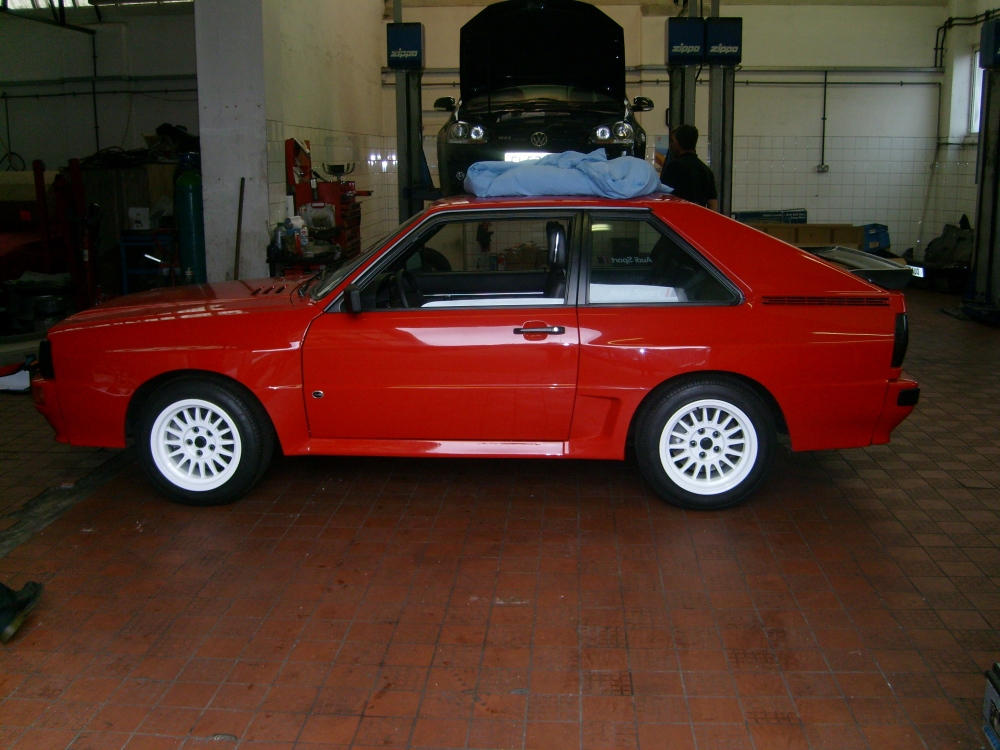

                  Originally posted by VwAudiMotorsport
                  ....and more upright windscreen so I also need a roof.
                  The "more upright windscreen" resulted because the Sport Quattro is not derived from the long wheelbase quattro. If I remember correctly, the Sport Quattro was derived from the "normal" Audi 80 2 door quattro sedan (which had the more upright windscreen). The drivers of the A1 rally cars were complaining that the laid back windcreen of the Urquattro was creating too much annoying glare. Hence, the sport quattro windscreen is more upright. This makes it *very* easy to spot a "Sport quattro" that has been converted from an Urq. Also requires an Audi 80 2dr to get the roof and "A" pillars correct.
                  But you knew that.
                  Real one:
                  Urq conversion:
