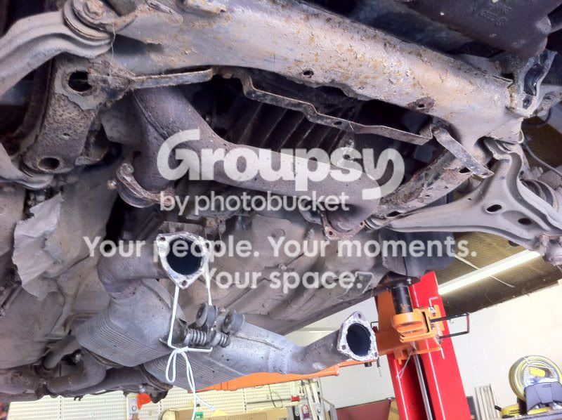

    Ok, took the old front wishbones off weeks ago and went to fit the new ones today and can't remember which way round they go. Does the wider gap go to the back or front and does the ballpoint angle towards the front or rear?
    Any help would be appreciated?
    Thanks
    Andy

    It's a pic from underside , hope that helps
    Eric

      Originally posted by irishs2
      [IMG]
      Many thanks, that shows me which way the ball joints should face but unfortunately I only have the lowly pressed wishbones and not the very nice forged ones that you have...
      Thanks for the help
      Andy..

        Woops sorry about that , this shows one side , it might do
        Eric
          Great, so it looks like the smaller recess is to the front....
          Many thanks for the help..
            Cheers
            Andy
            It's quite obvious when you come to fit them as it looks like they'll contact the anti-roll bar if the recess isn't at the right side. Ball joints towards the back, as has been covered.
