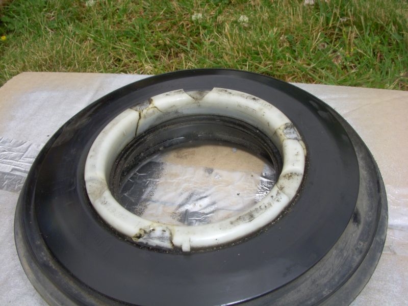

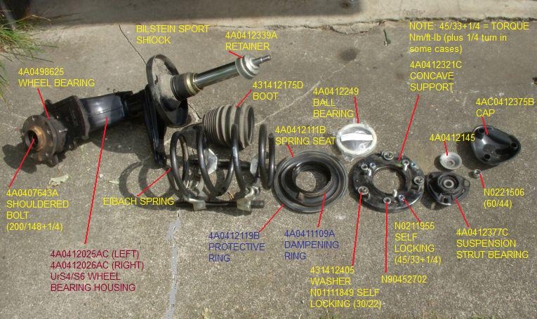

    If you have a working good Item 32 ball bearing, there is no spring wind up (and ping) when you turn the steering wheel.
    However if some lummox (not me) installed the Item 32 ball bearing that allows it to get crushed, it no longer works and the spring *IS* wound up during a turn = sproiiiiiing.
    Damaged/crushed ball bearing (there are three factory indents on the edge, not 6) :
      • 4754

        Hi Dave, I'm wise to that potential mistake.
        With the help of your links, my knowledge of the UrS6 is catching up on my experience of the B4 S2. Although everyday is a school day when it is only a hobby / obsession.
        I've cut the plastic off the springs as the car should be a eighth of an inch lower on reassembly, 'every little helps', so we'll soon see if there is any downside to removing the plastic sleeves.
