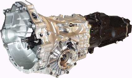

    Hello
    What is the difference between the drive shafts in the gearbox of the Audi S2 and Audi 100 S4?
    Part numbers would be:
    01E311105H
    01E311105J
    Thanks for your Help

      Well looking at the part numbers, they're the same part only the one ending in J is a newer revision.
      VAG uses an X at the end to denote a refurbished part.

        1st gear part #
        01E 311 105 G
        01E 311 105 J
        01E 311 105 E
        01E 311 105 H
        01E 311 105 Q
        Characteristic (click for pictures)
        narrow
        wide
        narrow, flexible
        wide, flexible
        Unknown. Used in 2001 and later A4 gasoline non turbo 6 speeds
        • AndyP
          • 6049
          Taken from here
          Audi 01E transmission gearbox technical information A3 S3 A4 S4 TT S6 S8 allroad RS6 RS4 RS2 S2 quattro tiptronic A6 A8 Audisport motorsport automobile car Quattro 4WD 2WD 4x4 Porsche 968 vehicle luxury nsu quattre anneaux horch dkw sebring le mans spyder avus france voiture bagnole car moteur sport quattro coupe endurance ingolstadt neckarsulm 24 h 24h heures du mans motocyclette motos moto casque prototypes concept cars pininfarina bertone oettinger caractere abt michelin pirelli stands photos forum chat

            Excellent breakdown of the parts' evolution, thanks AndyP

              In the 01E boxes all these main input shafts the same other than the later a4 01E boxes?
              As in narrow, wide, flex narrow and fel wide
              they all interchangable.
              I wasn't sure if bearings or the cut gear was different.
