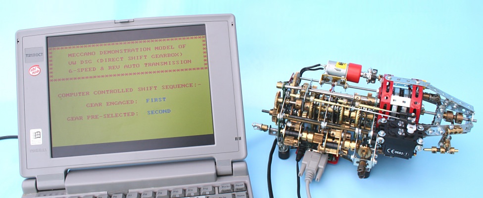

New gearbox anyone?
well
it is really nice to drive, and it has gearchange so fast you wont believe it. The next gear is allready "engaged" for you. The DSG as from audi and vw works like a charm, allthough it is more highteck to work on.
The upshift and downshift is so smooth, it is very strange to drive the first time.
We had some problems on the first skodas that came here with this tranny, but this was just changed complete, and new one in at once, other then that this, gearbox has hold up really well, even when (ab)used.

this
can be said in a simpler way like, When driving, one gear is always engaged and a second pre-selected. When the gearshift point is reached, one clutch segment opens in a flash while the other closes. The driver therefore hardly notices the gearshift process. This uninterrupted, efficient transfer of power enables particularly sporty driving.
Think the gearchange was about 0.2sek. If my memory serves me right.
while you are accelerating in 2nd gear, for example, the control logic is already pre-selecting 3rd gear, so that at the point of gearshift the 2 dual-plate clutch shifts in a flash and so to give a gearchange as undisturbing as possible, giving a smooth power transsfer to the wheels.japanischer industriabfall nein danke!!
