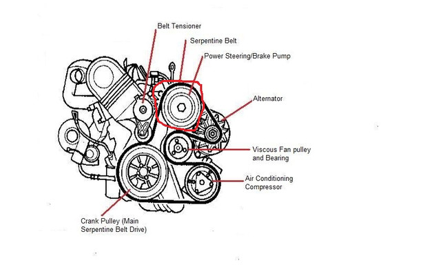

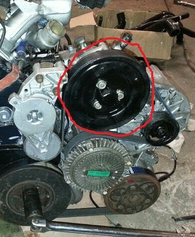

I've now made a bracket to relocate the standard pump on the opposite side of the engine under the exhaust manifold with some custom made hydraulic pipes.
There maybe an electric pump that works the barkes and steering but i've not found it yet.
