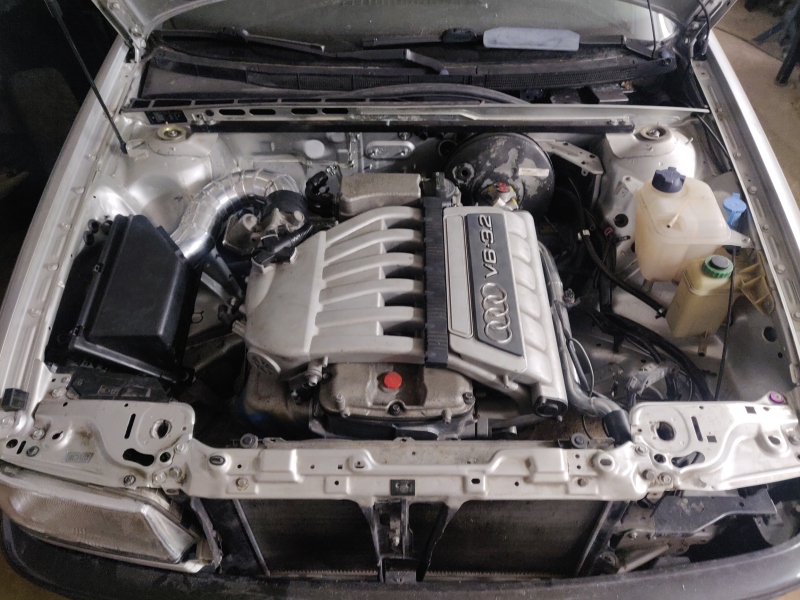

                              Long time no see. Engine is in, no clearens problems whit subframe or hood. All fits nice and have caps. Need to start thinking engine managment.
                              All the build is filmed and uploaded to my youtube channel. Feel free to check it out!
