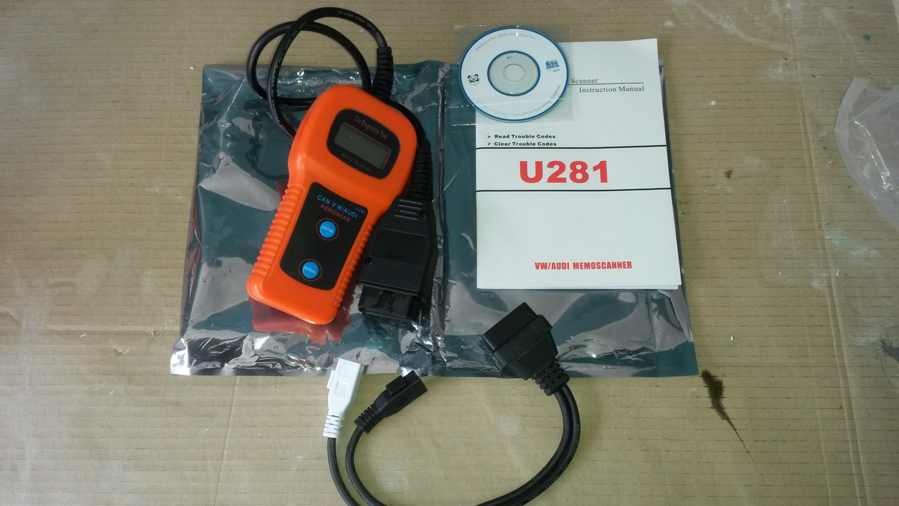

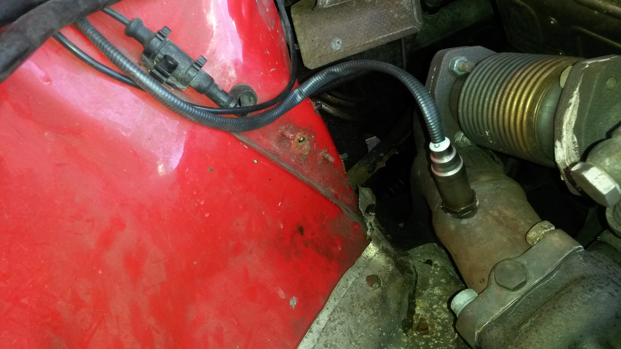

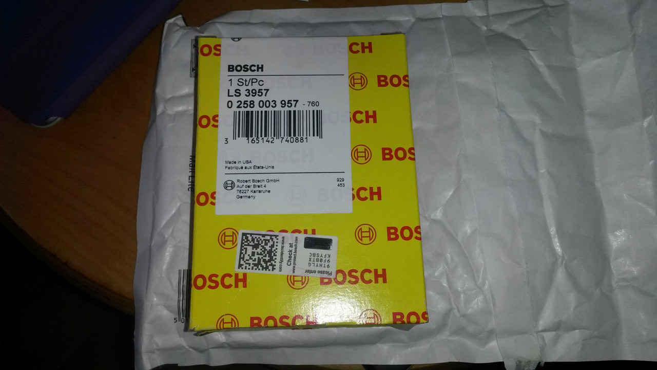

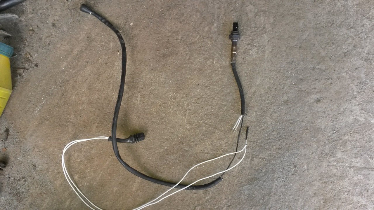

    I got myself a code reader and it came up with the code for a lambda sensor fault. So i got myself a lambda sensor:

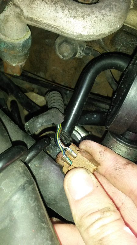

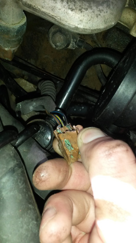

    After removing the old lambda sensor i'm not surprised it was showing a code. The wires had been cut:
    I fitted the new sensor which got rid of the code:

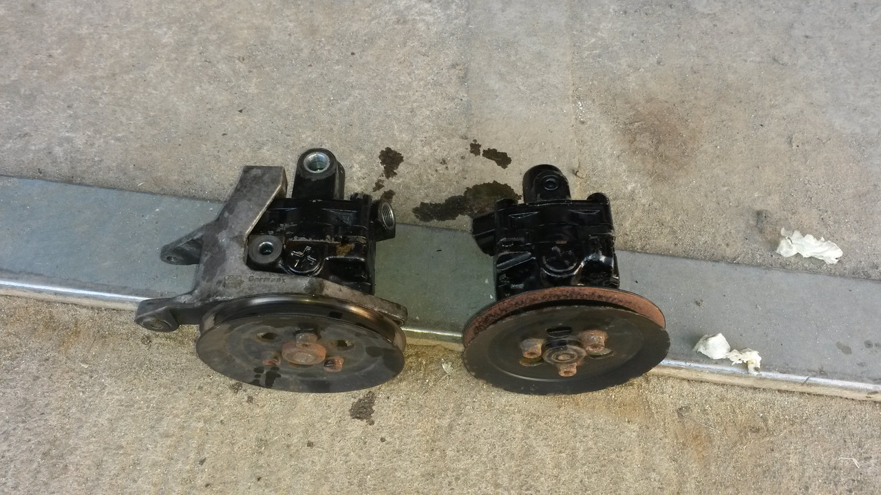

    I got a secondhand power steering pump from ERROR404 because my one was leaking and i wanted to rebuild it:

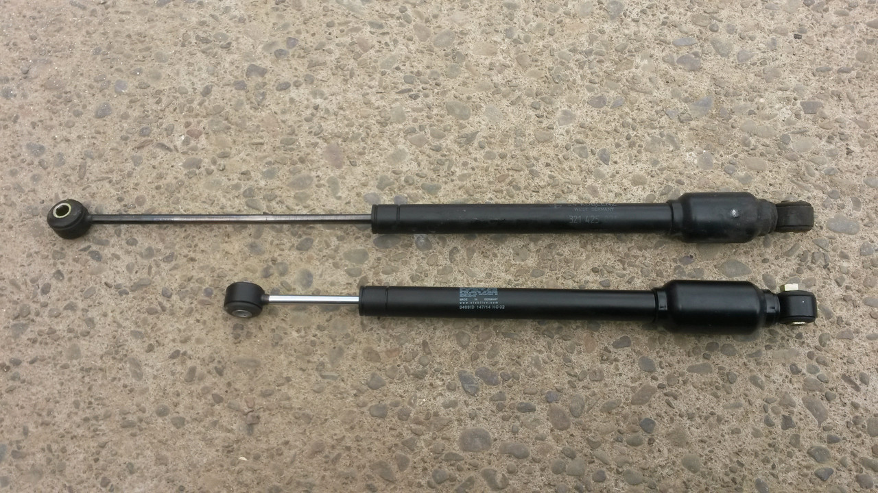

    My steering damper was knackered so i managed to get a new one:
    It made alot of difference to the way the car drives. Worth every penny!

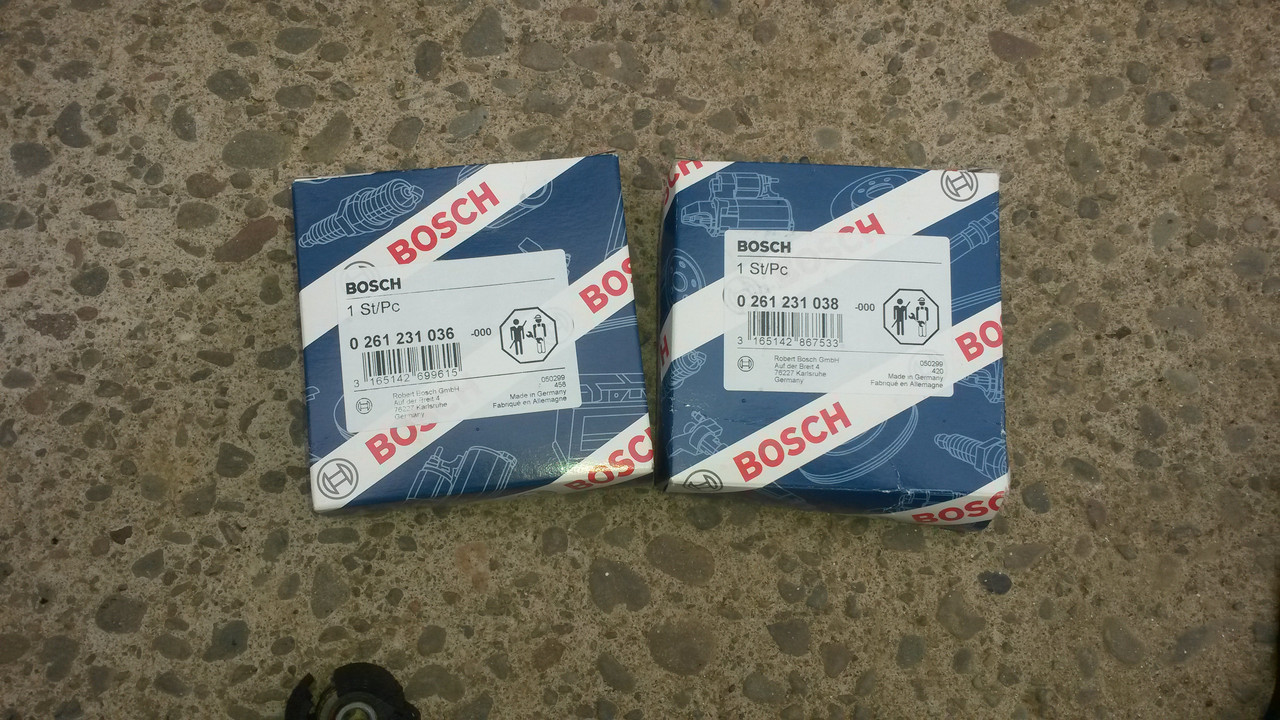

    I noticed my knock sensors were all cracked and broken:
    Got myself two new one's and got them fitted:

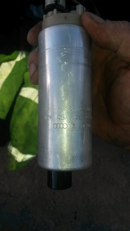

    I removed my fuel pump to see what it was like so i could order a better uprated one:
    My friend owns H tune and is an aeromotive dealer. So i got him to order me an aeromotive steath pump. I went with the 11169 GM inlet:

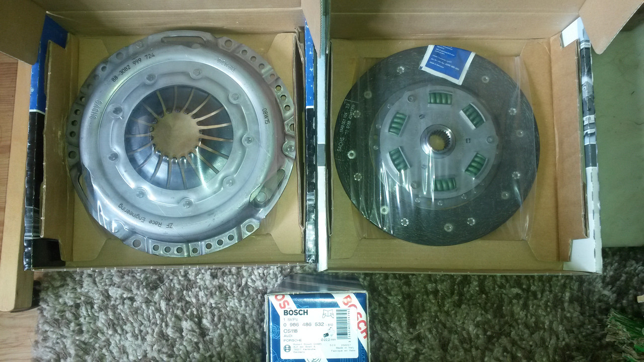

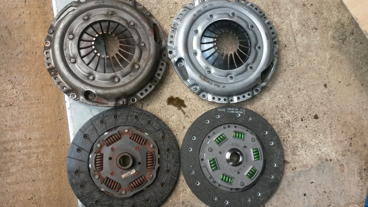

    I finally got round to getting my new sachs clutch and slave cylinder:

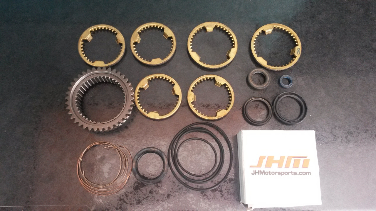

    and i decided to get myself a JHM full carbon synchro kit:

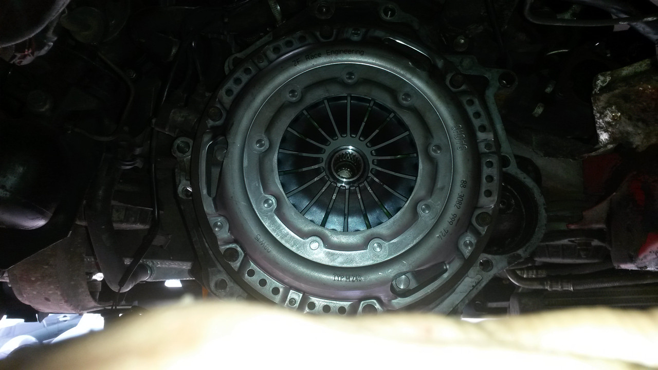

    So the old clutch didn't look to bad. It wasn't slipping but i decided to change it anyway for when i fit my new turbo:
    Got the new one fitted and torqued up:

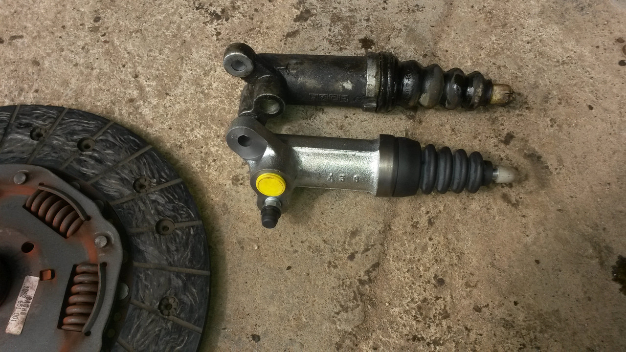

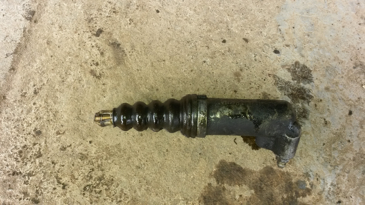

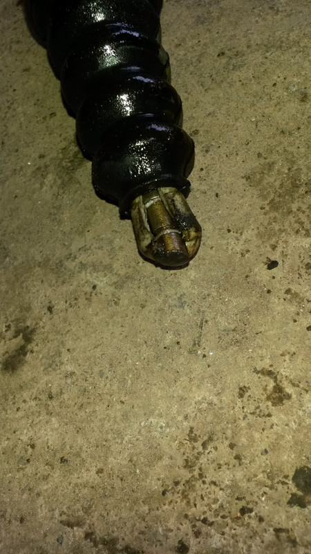

    The slave cylinder had seen better days too:
    I got myself a bosch slave cylinder which the bleed port was in a slightly different position but it still fitted:

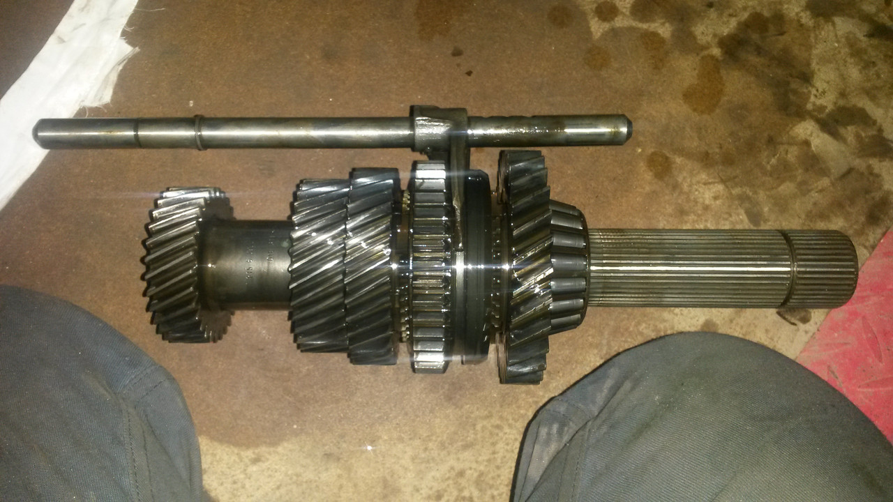

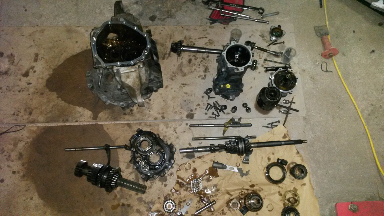

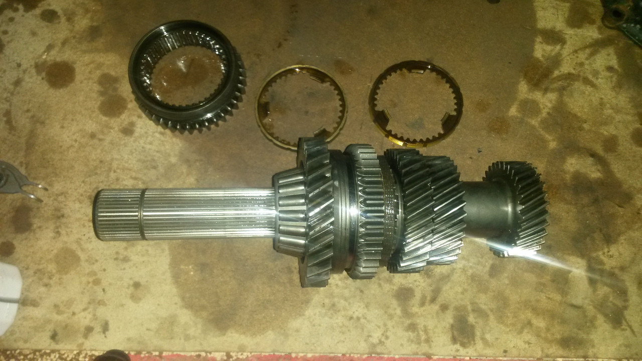

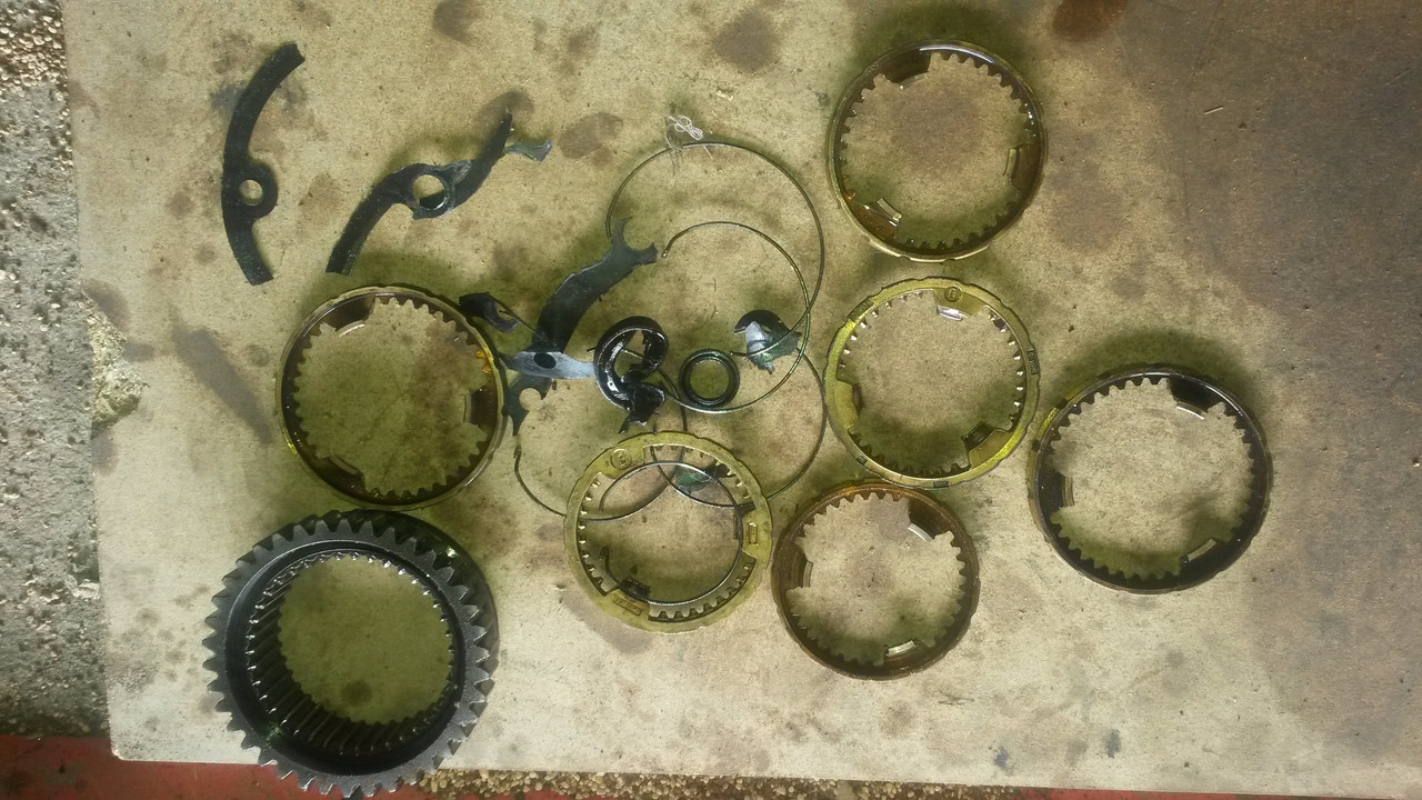

    I then set about the gearbox:
    New selector collar and 1st and 2nd gear synchros:

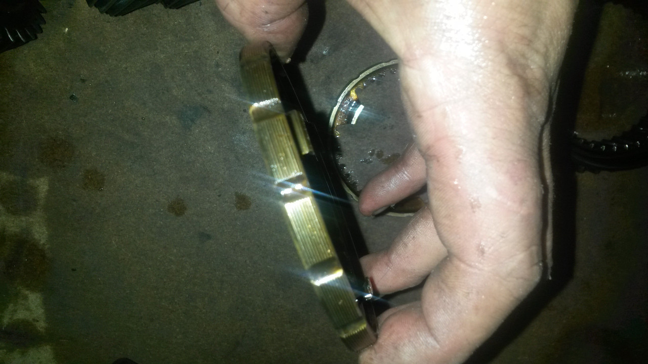

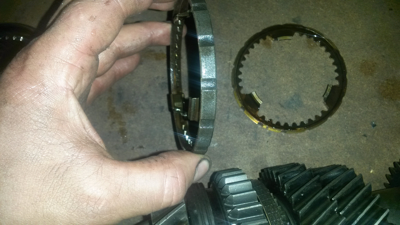

    Here is original audi second gear synchro. It was well worn and bits of brass were showing through the carbon:
    Here is the orginal audi first gear synchro which wasn't as worn as second gear:
    I tried to get more photos of rebuilding the gearbox but all the photos were blurred cause of the oil over my phone and weren't worth posting. Here is the pile of bit i had left over after i was finished:

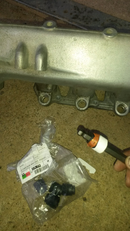

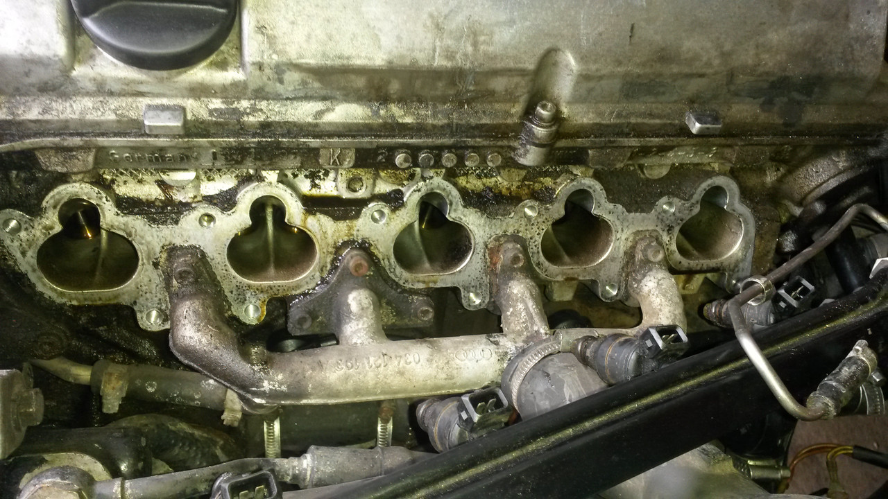

    The next think to do was remove the inlet because the injector seats needed removed. I ended up burning them out because the were stuck. I had to clean up the cylinder head too:
    I refitted the seats with gas tape and high temperature sealant:

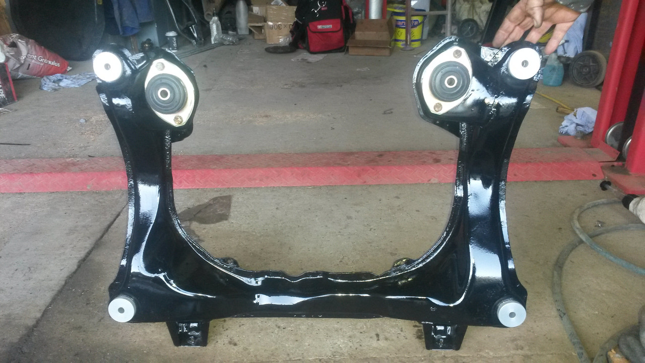

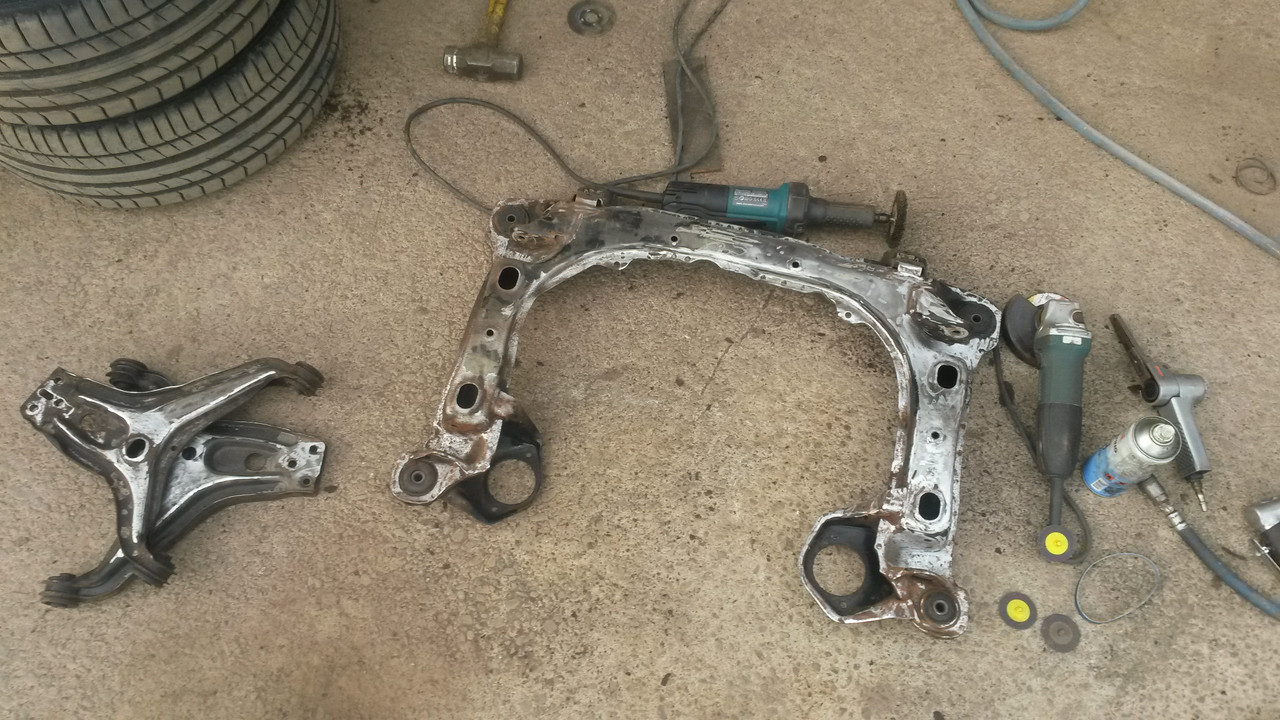

    While i had the front subframe i decided to clean up and repaint it before fitting the solid subframe bushes:
    Front subframe finished and bushes fitted. I used porsche 911 engine mounts for the gearbox:

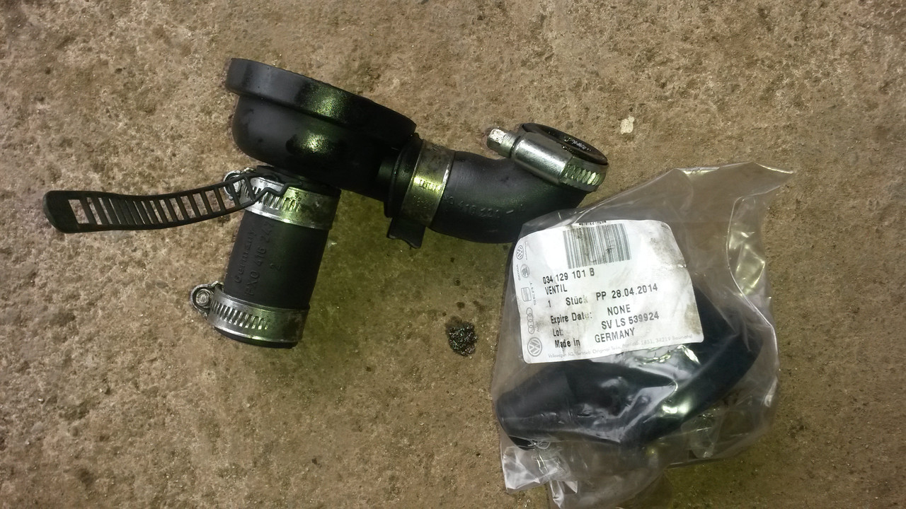

    I fitted a new crank case pressure relief valve and cleaned all the flame tramp and pipe work up:

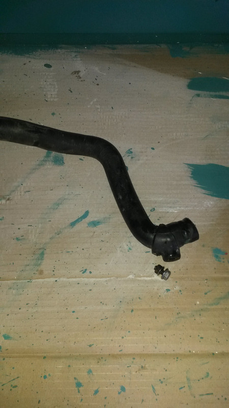

    My next problem is that the bleed point has now broken of the heater return hose:
    Going to phone audi today see about getting a new one.

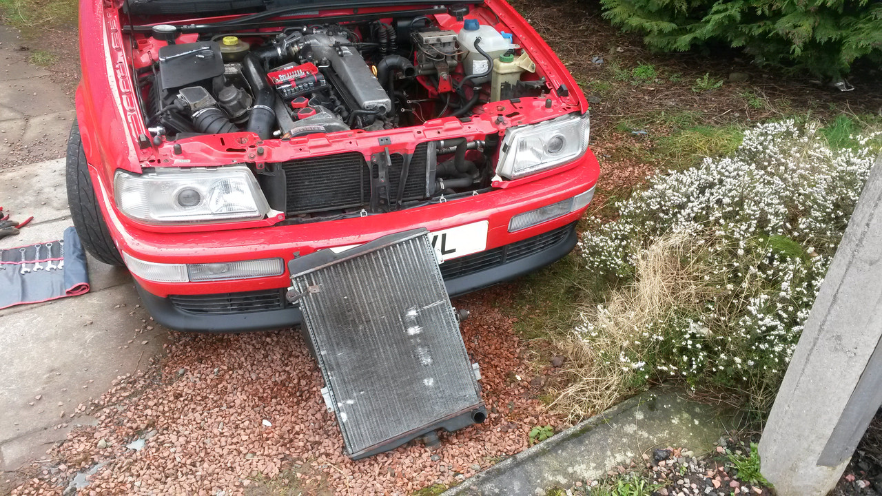

    Well its been evenful few weeks. Got the burst radiator stripped out of the car:
    after removing it the waiting game began. I had payed next day delivery for the radiator, but two days later it still hadn't shown up. I then received an email to say it had been dispatched and would be with me the next day. It finally turn up and straight away i notice a hole in the box:

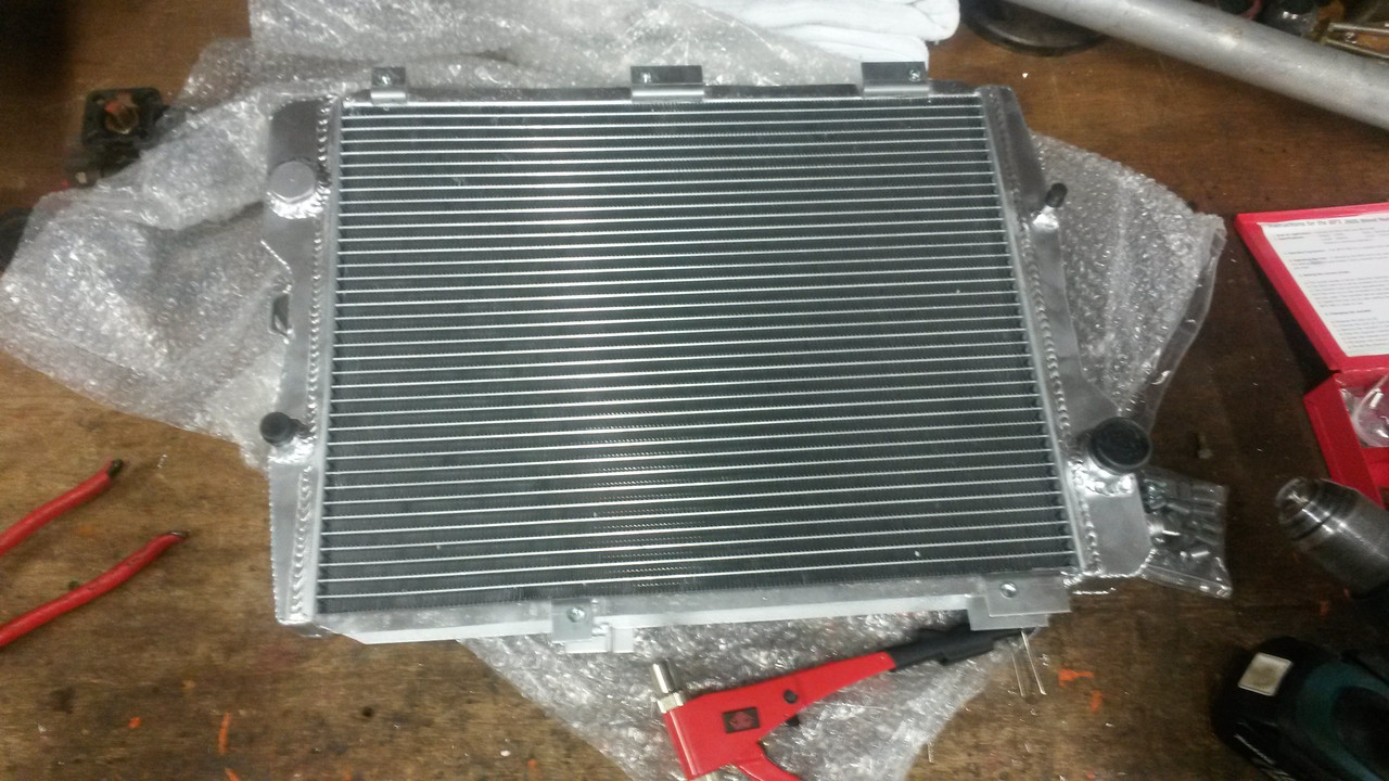

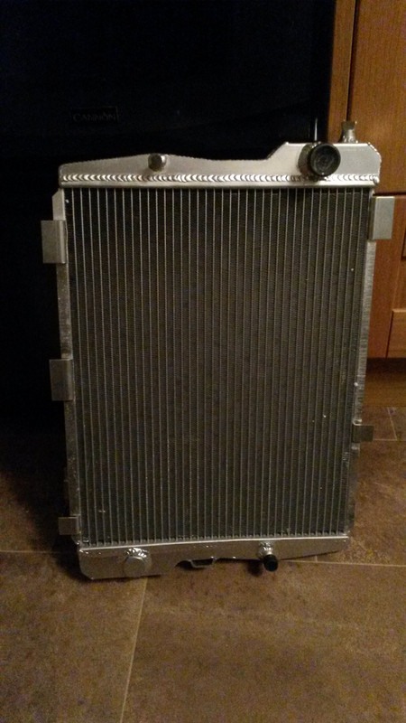

    Luckily i received an email from a previous company i had ordered an alloy radiator from. I got sick of waiting weeks for it and cancelled my order. They said they had a radiator in stock and wondered if i was still interested. I bought that and waited 5 days for it to arrive:
    I got the radiator from here http://www.carlicious-parts.com/epag...Products%2F496

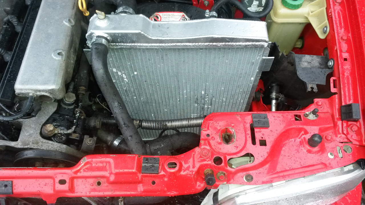

    The only thing i had to do to it was add mounting holes for the fan cowl:
    Got it all fitted:

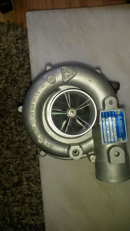

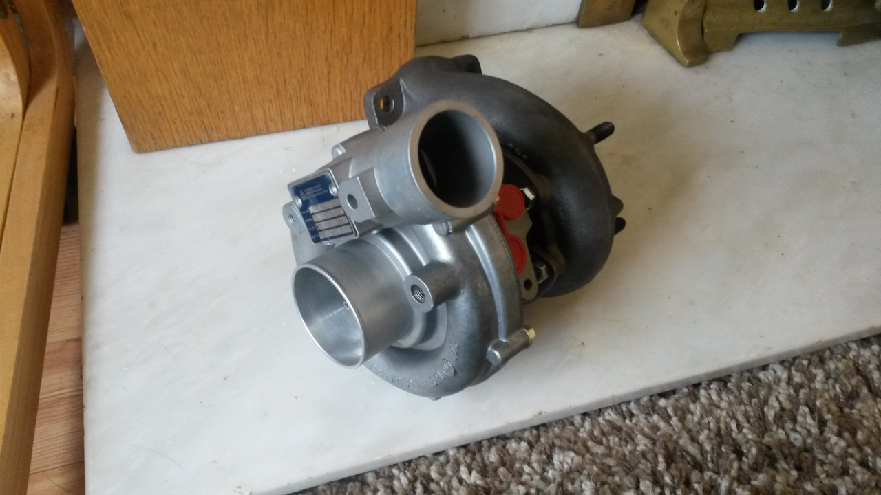

    I finally received my turbo from Albert :
    Still got a few things to get before i fit this. Need to sort out some injectors, a fuel pump and the downpipe and exhaust.

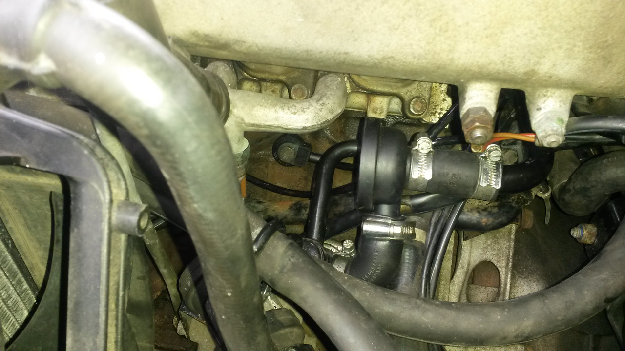

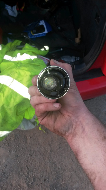

    When fitting the radiator i noticed that plug on the thermostat on the coolant rail was damaged:

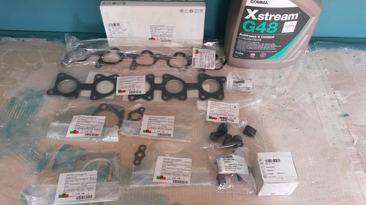

    I ordered a new plug and some gaskets from audi:

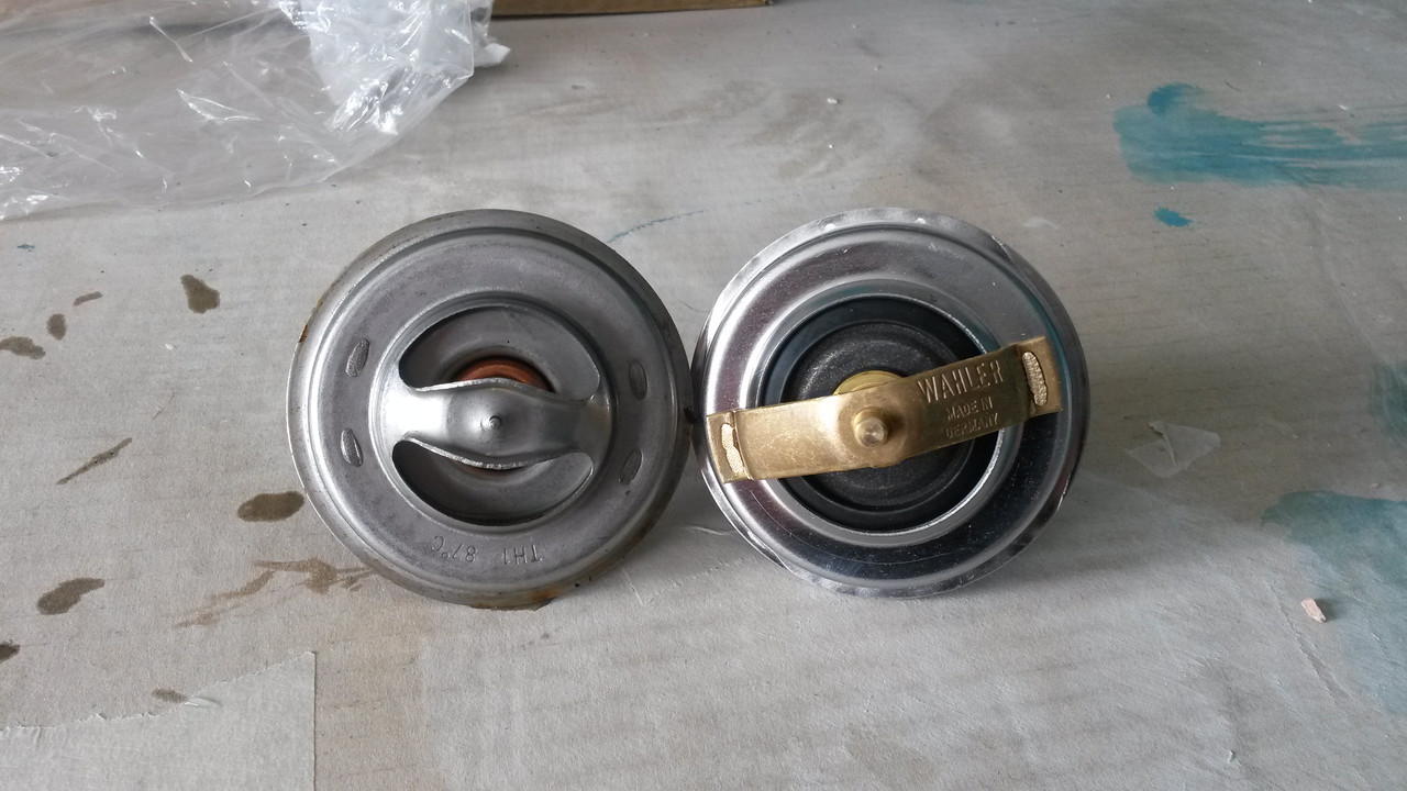

    I decided to get a new genuine thermotstat for the car:

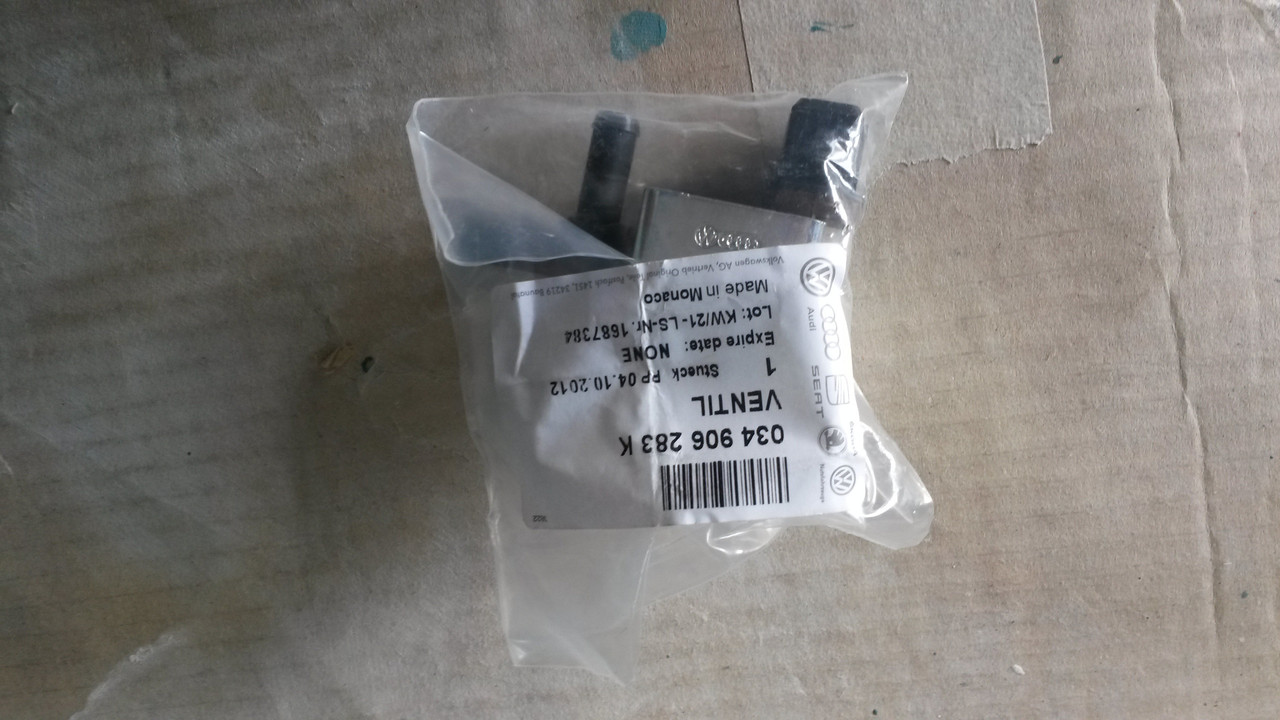

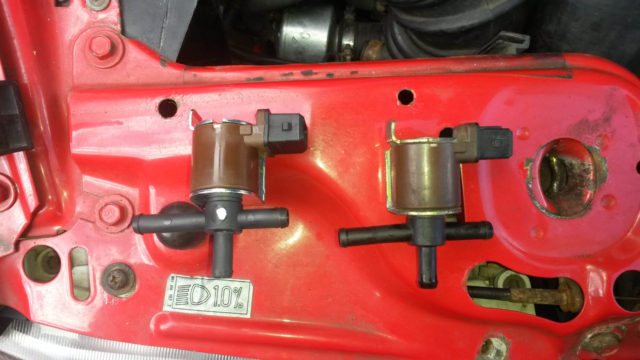

    I got a new N75 valve and fitted it too:
    Fitted my new plug too:
