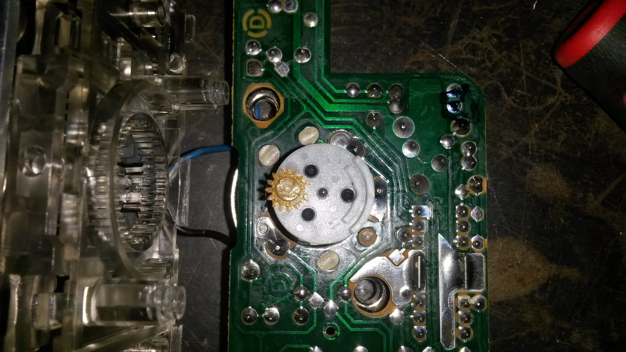

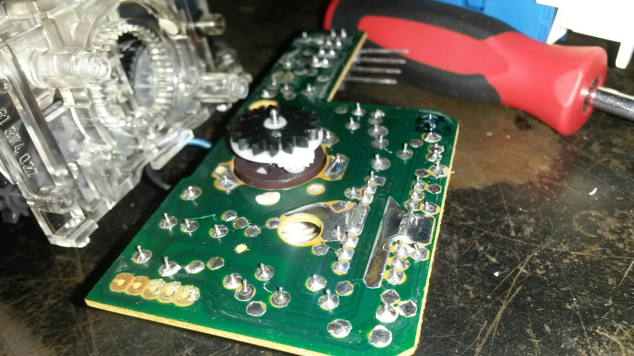

    Got few more jobs done on the car. First one was replace the broken oddometer gear after getting a new gear of Greg S.
    the old broken gear:
    New gear fitted:

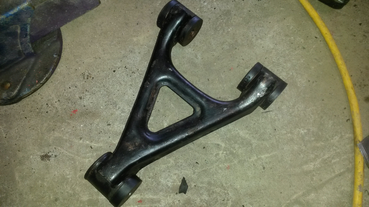

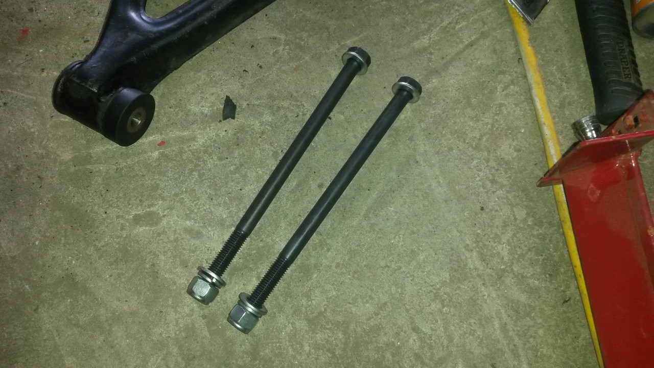

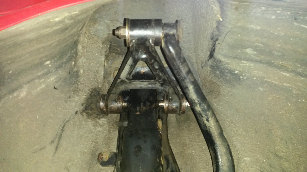

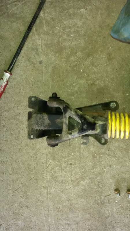

    Then i turned my attention to the knackered rear upper arm bushes. The bolts were seized to the bushes but after a bit of soaking with penetrating oil i got them loose and the arm off:
    i decided to buy some power flex inner and outer bushes for them:
    I got some new nuts and bolts for them too:
    All fitted and tightened up. No knocking or rattling from the back end anymore:

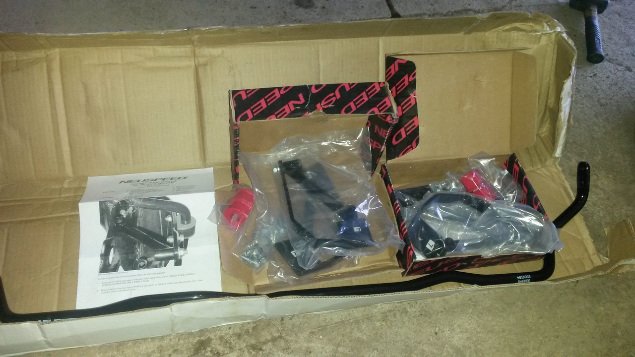

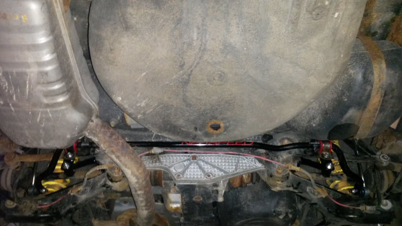

    I also treated myself to a neuspeed rear anti roll bar:
    It was really easy to fit. I haven't had it out a proper drive yet to see if it has got rid of the understeer:

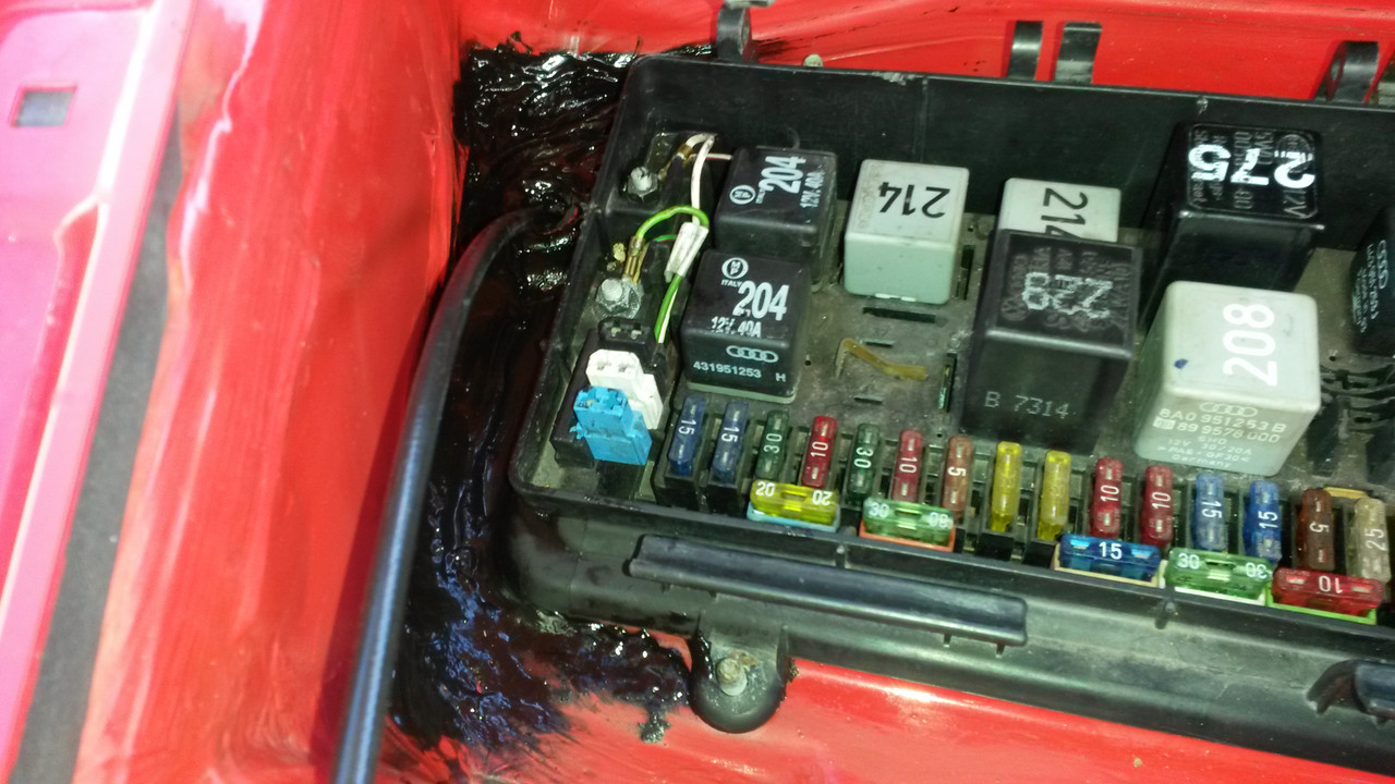

    I smoothed the sealer to the bottom of the drainage whole.

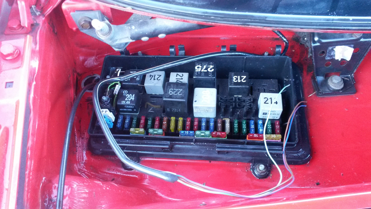

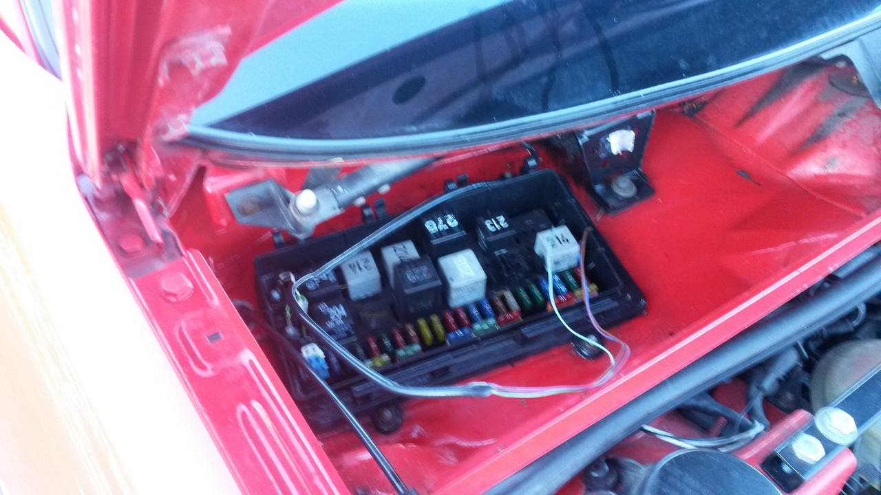

    Originally posted by andy j
    can anyone tell me what this cable would have been for? it was tucked behind the fuse box:
    I'm pretty sure the wires are for the under bonnet lamp and possibly heated windscreen washer jets. Take a look at the bottom of the jets to see if they each have a two pin plug to confirm this.

    Ugh, I hate water ingress. But be careful, there is a hole there that allows water to run out onto the inner wing. That shouldnt be blocked.
    This looks like the loom for the heated windscreen washer jets.

    On sunday i started to have a look for the leak. it seemed to be coming from the bonnet cable:
    The sealer looked ok but i decided to remove it and found water and dirt under it:
    i then used sickaflex to reseal it. Its not prity i know but i'd rather this than water in the cabin:

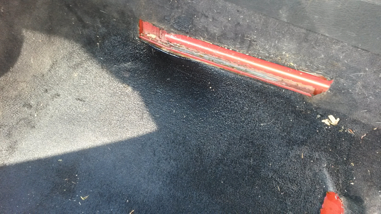

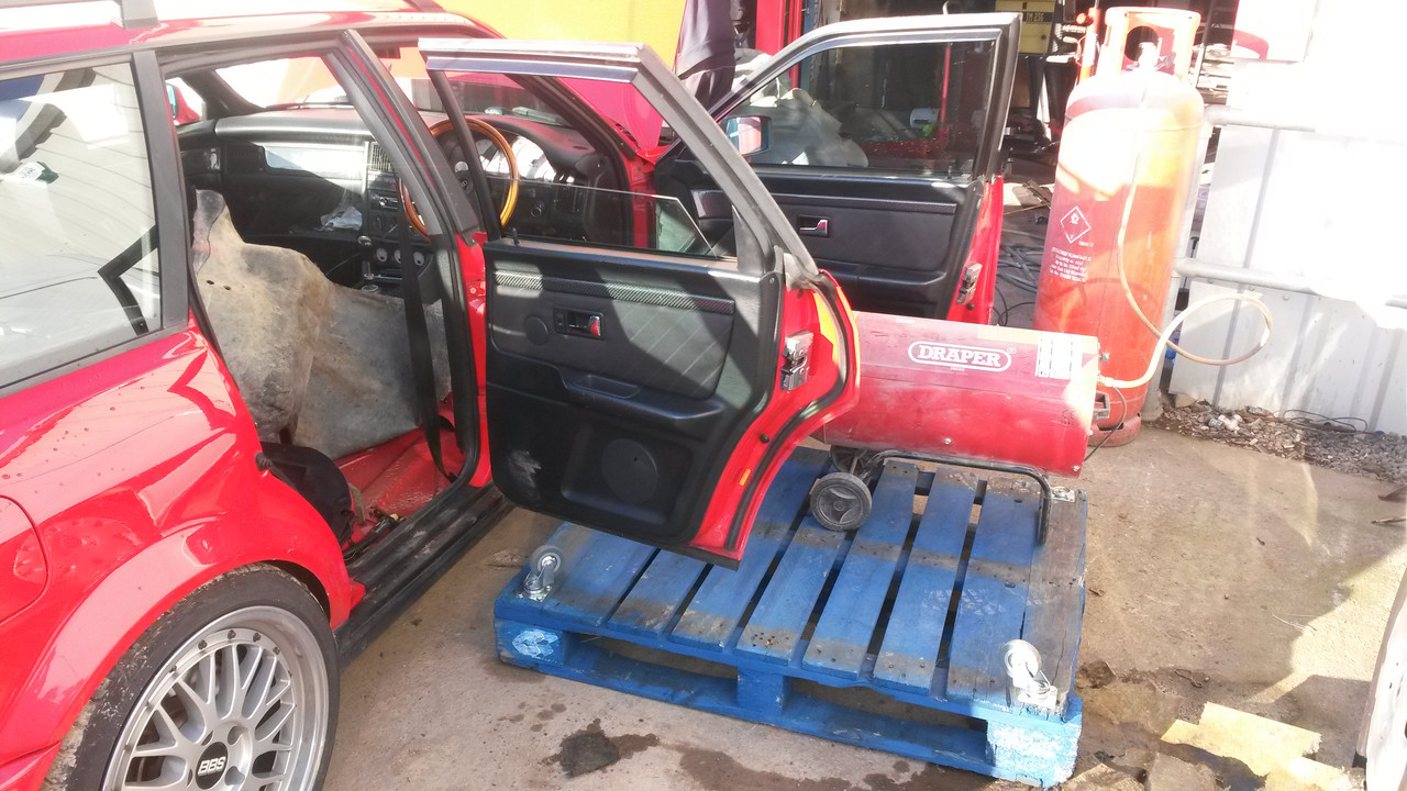

    I then removed the drivers seat to lift the carpet:
    The sound deadening was knackered so i removed it:
    I then held the carpet up and use the space heater to dry it out a bit:

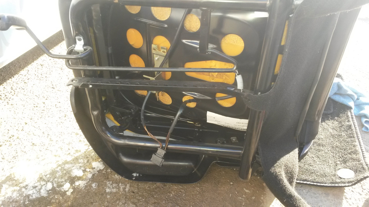

    I noticed that there was a plug under the drivers seat. It looks like the seats are heated.
    I think they are out of a golf. I will need to have a look to see if its possible to wire them up.

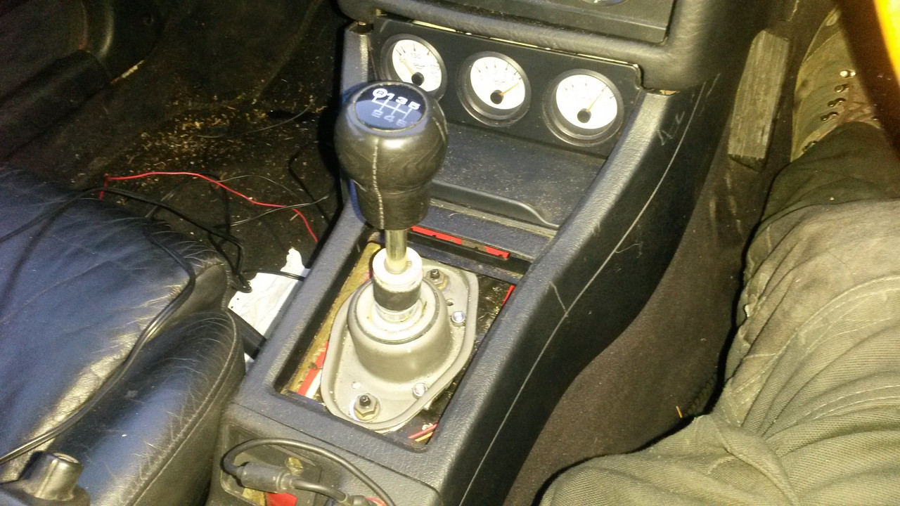

    The other job i have done this week is fit my golf gear shift balljoint. I used the guide Rusty had written up and got the shifter working well:
    it seems there is still some play with the shifter which will probably be the shifter rod balljoint. I haven't decided yet whether to get an audi joint or the 034 one.
