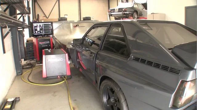

                            But here is my update of the last week or so.
                            Pretty exhausting last weeks trying to get the car finished map the car. The first dyno visit learnt that the wastegate was to small. So drop in a 60 mm tial for the 44 mm. And fitted the carbon clutch that came from repo. In the end everything fitted but there was a lot of work and stress involved there.!
                            Then it was of to the dyno again. Sadly when loading the car on the trailer i had my first damage to the frontend of the car. F*ck!
                            Did not crack the bumper luckily but it will need a respray.
                            Eventually on the dyno, we had to fiddle around with WG springs to get the base pressure right. This was then solved and mapping could commence. 3 lambda sensors later (they broke down) we then were able to make some boost. Mapping all went smooth and the first baseline mapping was done. However after lunch we did another run and EGO correction was off and in one case around 20%. So something was seriously wrong. We've trouble shooted everything in the car. Measured everything. Made new power lines to the ecu, even soldered and double checked the VEMS ecu itself. In the end we were down to the injectors. These were new 1700 cc's from bosch. And after changing to other injectors the problem was solved. This is pretty strange for new injectors, bought from bosch. So more research showed that maybe a very small drop in voltage from the alternator caused the injector time to be changed that substantially. After this we've already spent a 2 days till 11 at night figuring out what it was and doing test runs on the dyno... :S
                            So yesterday I went over to the dyno with the rs2 to swap over the 90 amps alt for the rs2's 120 amp alternator on the SQ and again to test if this would solve our correction problem. So this took a while, and finally at 6 last night we were able to fire up the car. The engine was cold, it hadn't run yet that day. Imediatly after starting we heard a load noise and saw oil flying everywhere in the trunk, and out the trunk. The RS2 was standing 2 meters behind it and was covered in oil from top to bottom. The trunk was one big oil massacre. Quite scary. What happend? The oil filter seal was blown out and oil was pushed out there. After removing the filter it showed that the internal filter element was collapsed completly. This was probably due to the 4 stages on the return pushing cold oil through it. But still it was weird. Even weirder was the oil on the hood of the RS23 that exposed aluminium shavings in it. Ow dear.... We were hoping it came out of the oil filter. but further inspection showed that this was not the case. Shavings were found everywhere in the system. Minor shavings, but still.... This is pretty serious. So next up is dismanteling the engine and drysump and see what the damage is and where it comes from. My first hunch is the oilpump.... But time will tell what it is exactly.
                            So last night again another late night and around 1o'clock in my bed.
                            One problem (blowing the oil filter) exposed another problem wich is way more serious. Hopefully damage is not to bad.
                            At least we have checked and double checked the car inside out. This also brought some new less fortunate stuff in the light of day. Compression is low on 2 cilinders. This was measured days before the oil incident. This however is not a really big disaster because a rebuilt of engine, and a new upgraded cilinderhead were already in the planning for this summer.
                            In the end we did map the car on 1 bar boost on the setup. Intake temps were nice and stable after the chargecooler. And in the end we made 374HP with a revlimiter on 7000 RPM. Boosting starts a 4K rpm and full boost is on at 6K. So for the first test it's quite ok. Just a shame we havent been able to turno the boost up to full swing. But, perhaps that saved me from having catastrophic engine damage.
                            One happy note. At least we have a video of the dyno run
                            This is "Sq dyno" by Jeffer on Vimeo, the home for high quality videos and the people who love them.
                            Off to get some well deserved rest now...
