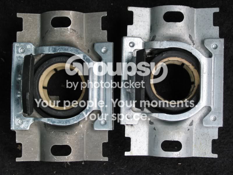

Careful of this bit, it can be hard to find.
New vs old. A new spring clip was used too. The ball was lubricated with a little red grease and refitted.Comment

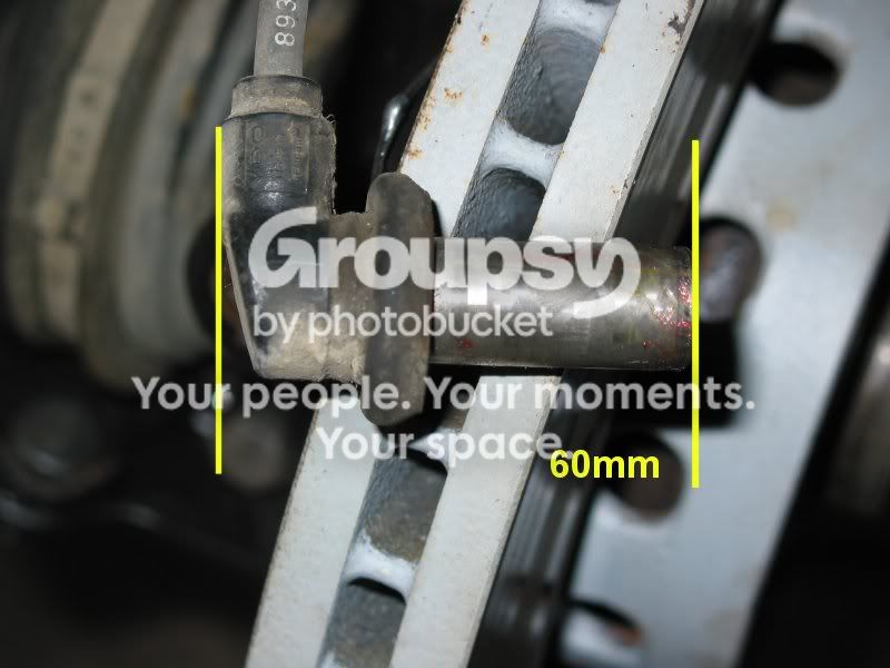

ABS was not working properly. I figured I did not push the sensors in far enough into the hub, and if I did I was not consistent with my air gap between cv and sensor.
So out with my vernier calipers and I did some measuring.
From surface of hub to top of the tooth on the cv joint was 35.8mm.
My sensor is exactly 60mm long at highest point.
If I push the sensor in all the way in to contact the tooth the sensor will protrude 24.2mm from the hub. Add the recommended [s]3mm[/s] 0.5-1.3mm air gap that I found in various places on the forum, giving [s]27.2mm[/s] 25.2mm of sensor protruding from the hub.
This calculation was done on the front hub, the rear hub turned out to be approx the same with 0.3mm difference. After clearing the ABS errors with VAGCOM, I took the car for a little spin. ABS problem seems to be gone.

Damn ABS, what a nightmare to adjust properly. While making the sensors all equal did stop the juddering at slow down, the abs light kept coming on while at speed. A bit more research I found that the appropriate sensor ring gap is 0.5-1.3mm ... With the ABS sensors pushed in that little bit more all my ABS issues had gone. ... for now.

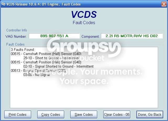

Of course it never ends. Car cut out twice while driving.
Vagcom:
I checked the wiring around the camshaft and around the cover and back along the fuelinjector wiring, no really obvious wear, or chaffing.
Still trying to find where the issue is. I might have to replace the cps sensor.
