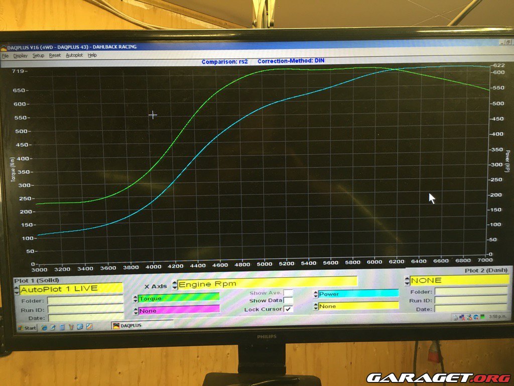

          442whp on DynoPack...

            Nice! Is this on the 5862 turbo and A85? Do you have a dynograph?
              I'll take a guess...At a conservative 1.7bar on e85
              Sent from my HTC One using Tapatalk

                #247
                Yep 5862 1,65bar but not on E85... Yet!
                E85 will ad another "100"whp.
                /Thomas
                RS2-94

                  #248
                  Really nice to see... So this is pump fuel?(93oct, RON98?)

                    #249
                    Yes 98okt... I can post the dyno tonight

                          #252
                          622whp 719nm E85 1,9bar...

                            #253
                            622whp And 719wnm on @1.9bar 5862? Thats insane!
