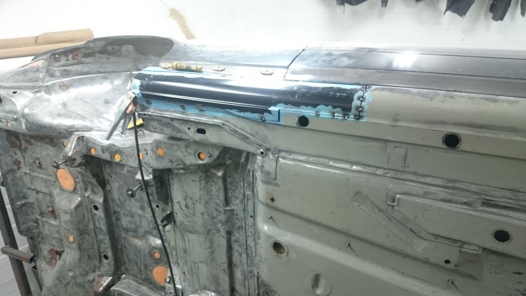

    When i was removing the sealer i also found out that somebody have tried to fix the door sill on the right side back and they have done a bad job!
    They have tried to pull out the dent and after they just left the holes from the pulling pins open and put some fiberglas putty over it and paint
    I just replaced it and welded in a new piece

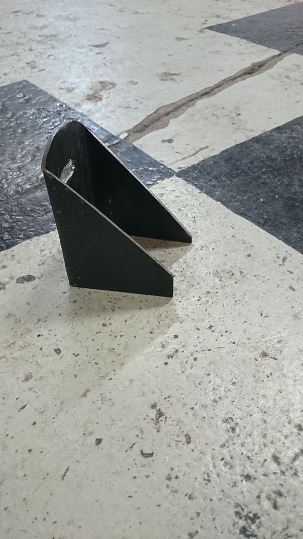

    When i started to take apart the car i saw that one of the rear diff mount on the subframe is a bit rusty and bad and also the metal under where the bracket was standing in the subframe so i made a new diff bracket and made a new piece for the subframe and welded it back on place

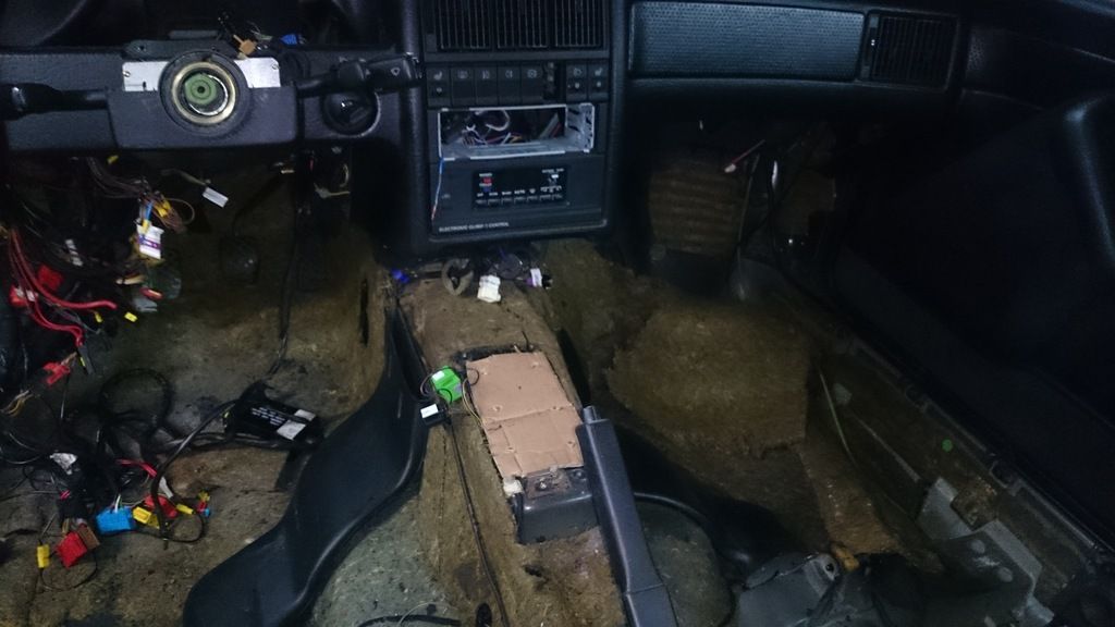

    I have also started to take apart the inside of the car a little bit but not finish yet
