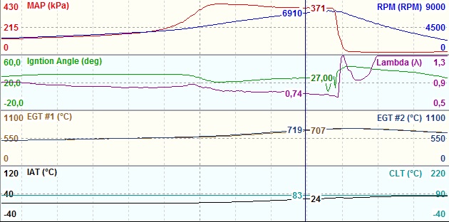

    Here is the datalog, as you can see we pushed some parts pretty hard EGT1 is mounted in first cylinder, EGT2 in fifth cylinder. On the street the EFR8374 hits full boost at 4100rpm.

                              @butchone, yes I can send you. As you can see it was pretty brutal ignition, won't recommend that for track race for example because the thermal reserves are limited with 3bar boost But for spinning 4 wheels on street sometimes its perfect
