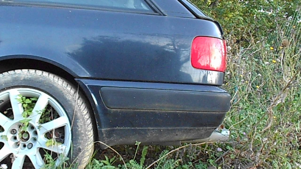

    I have bought this car 2 years ago for parts, when i bought the car no problem with engine, no smoke. some days or weeks after some smoke coming. I do this video some days ago :
    When i start the car cold :
    2/3 mns after
    I stop the car, waiting about 20/30 mns then sart the car again
    i cant see any water consumption. Oil level seem to be the same ...
    It could be gas injector ?
    No problem on VAgcom
    Thanks for your 2 cents
    Tof
