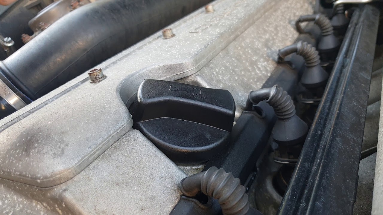

Curious to hear your thoughts on this. It started very suddenly when out for a drive. First symptom was lots of blue smoke out of the exhaust when sitting at traffic lights, then after further investigation i found my catch tank was being filled with engine oil very quickly. As in its dumping a pint of oil into in within 10-15minutes of driving. Then there is the high crankcase pressure, which explains it puking out the engine oil into the catch tank.
I suspect it has broken a piston ring as i cant see what else could do this, but curious to hear other suggestions before i take the bottom end apart.
