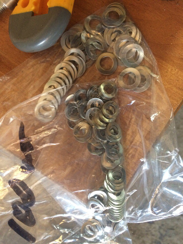

              I feel some hope to keep my bolts with these:
              DIN 137B spring washers. Similar to what factory fasteners on these motors had.
                I use DIN7980 spring washers on all the M6 fasteners, on the sump, oil pump and rear main seal - never lost one yet
