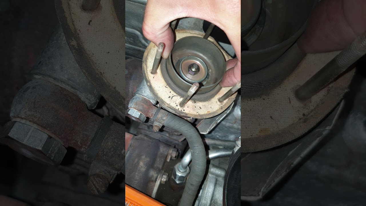

    Did a RS2 boost leak test yesterday and pretty much it bled all the air directly trough the wastegate, and quite fast. Blocking the hose to the lower chamber revealed the system is airtight with no leaks. The car does reach its boost level but it isnt the quickest spooling RS2 I've driven... is this amount of play on the WG-valve a massive amount or is it still a normal bit of wear? Never checked this before but I'd say the valve guide has almost vanished?

          Took it apart today.
          When removing the wastegate the valve seat was lying on the manifold... that was a first! It sits loose in the bottom of the WG so that will need attention.
          Aside from that the valve shaft is worn as hell. Some places a low as 9.6mm, and it has been grinding a lot on the guide which is also heavily scored.
          Going to take it to my machineshop and have the valve refinished with a custom new guide. The valve seat will hopefully be fixeable.
            Got it redone with a new bronze guide and the valve cut down to 9.5mm with 0.1mm guide play. Seat also nicely lapped. He installed a thin inner bush in the guide that can easily be replaced should it ever wear again (probably not in my lifetime )
            Curious to how it will feel now!
