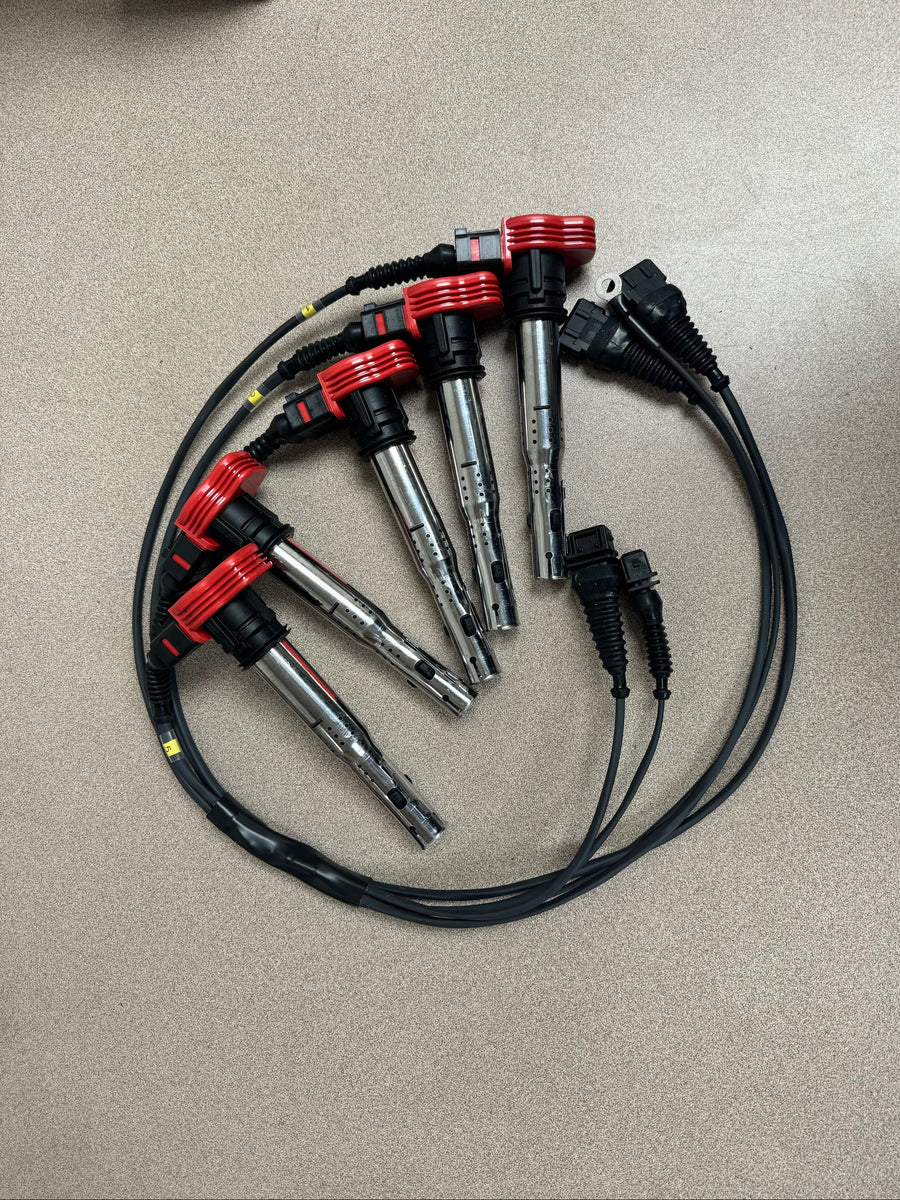

    Been thinking of doing the same with my S4, I have come across this.
    Another plug and play coil option for the 5 cylinder 20v turbo engine, the 1.8t coilpack kit actually uses the coils from the later 2.0tfsi motors (part number 07K 905 715F) which are taller and stronger than the older 1.8t coils. Direct plug and play fit for the original S4/S6. Will not fit the 7a or 3b valve cover wi
    Looks good, although i see looms on ebay alot cheaper, and wonder if the 1.8 and 2.0 coils have the same plug?
      You can buy a high quality harness from a forum member here.
      Our TFSi coilpack conversion harness for the ABY/ADU & AAN is plug & play with the factory engine harness. Wired using high temperature aerospace / MIL specification wire with and silicone coated braided glass fibre sleeving for ultimate heat resistance - our harnesses are not the cheapest but they are the best.To carry out the TFSi coilpack conversion, you will also need 5 x TFSi ignition coils, also available from Ultra Performance Engineering.
