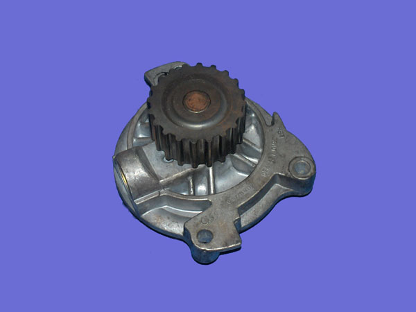

Which waterpump is this? Is it an RS2 pump, the previous owner state it is in some info I got on the car, but I don't get the part number to add up. 074 121 019C
And also, the car has a 3B block but with a AAN, ABY and ADU belt tensioner and a ADU camwheel, so what timing belt to use?

I would think that the 074 bit of the p/n implies its origins are from a 2.5 TDi 5 cylinder which also does not use the water pump as a tensioner. Might be from a VW commercial.

I beleive the TDi pump pulley would have 20 teeth. So count how many you have in case!
Its possible someone has pressed a 20V pulley on a TDi pump. The pulley on a TDi pump is wider to take the increased timing belt width of 26.5mm. The pulley width is @27mm. The pulley also appears to have threaded holes in it which I can't remember seing on a water pump before.
I have checked an aftermarket TDi water pump and can confirm the 20 teeth. I might be able to find an original used TDi water pump tomorrow to check the casting number against.
Doesn't look like a I5 pump to me!
Of course another explanation might be if its an exchange pump. Perhaps they just use whatever is salvagable like the casing and stick a new impeller and pulley in there!
If you look at the pics here you can just make out the same casting number but with a 20 tooth pulley! http://www.ebay.de/itm/EGU-VW-Wasser...-/160287308446
